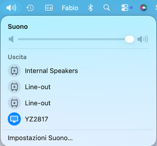

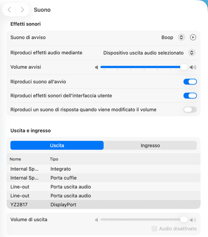

Tested HDAUniversal on my Hackintosh and it works perfectly
Question: The kext detects my monitor via DisplayPort, but I have no sound

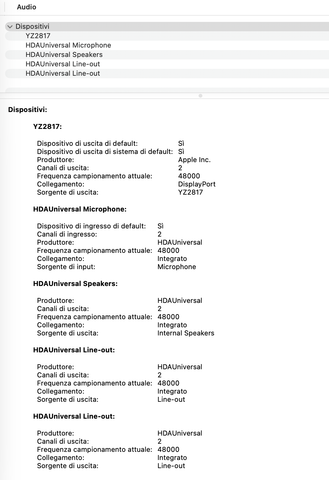

53 minuti fa, MaLd0n ha scritto:
Can u extract a dump with this? https://olarila.com/files/macOS-Applications/Collect-HDAUniversal-Release.zip
Comming from native things from Apple
There you go
HDAUniversal-Test-Logs-2026-06-27_20-11-28.zip
Edited by Alpha22
  • Like 1
CPU Intel Core i5-13600KF Raptor Lake / Motherboard Gigabyte Z690 Gaming X DDR5 / Graphics Card MSI RX 6600 XT / Ram Kignston DDR5 32GB / Fenvi T-919
macOS Thaoe 26.6.1 /macOS Sequoia 15.7.8 /macOS Ventura 13.7.8 /macOS Thaoe 26.6 Beta 5 /Windows 11 Pro
This output comming from com.apple.driver.AppleGFXHDA 550.1. DisplayPort/HDMI native Apple, via AppleGFXHDA.
Question: so, with HDAUniversal, is it not possible to get sound via DisplayPort?
  • Like 1
No. HdaUniversal is only for onboard audio. I can add this support, but need many test, debug, etc.
