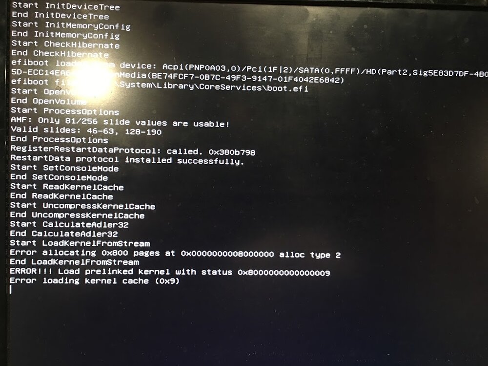

Mister3000 Posted January 3, 2019 Posted January 3, 2019 Hello everyone, I am new to this board but im in need of some help. These is my laptop: ASUS N53SV i7 2670QM 512GB SSD Intel HD3000/Nvidia GT540M (computer originally with 720p panel but replaced it with 1080p) Now, I have been running OSX Yosemite (10.10.5) for years on this laptop with no problem. my issue is that i tried to upgrade to High sierra and all I got was an error on the screen. so i gave up. Now i'm trying to upgrade to mojave but i have read that HD3000 support has been dropped. I have downloaded both High Sierra and Mojave any suggestions as to how should i proceed to try to upgrade ? Can i go up to Mojave and if so, is there a guide you can point me to that i can use to build an installer USB for my machine ? Thanks in advance for your help
Administrators MaLd0n Posted January 3, 2019 Administrators Posted January 3, 2019 [ref]Mister3000[/ref], post one photo here with error screen use high sierra and avoid some problems -Guides and Tutorials HERE -Hackintosh Tutorial Database - HERE -The largest EFI folder collection for Hackintosh HERE -Support Olarila Vanilla Hackintosh by making a donation HERE -Professional Consulting for macOS Hackintosh since 2006 HERE

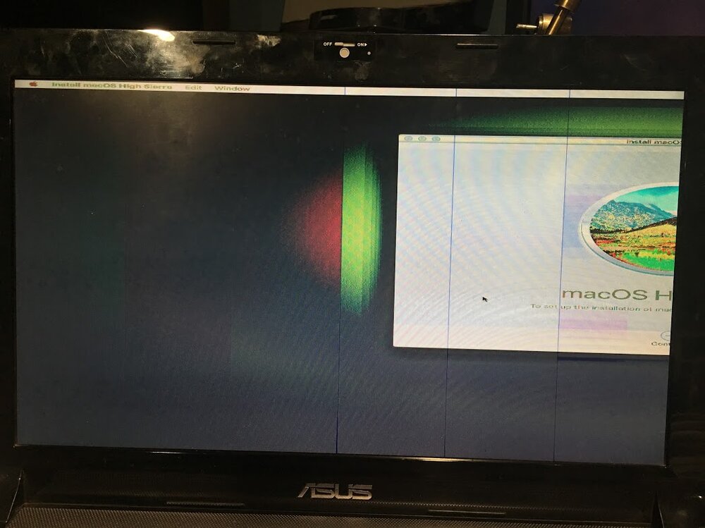

Mister3000 Posted January 3, 2019 Author Posted January 3, 2019 ok, thanks for your response.. i'm going with high sierra as instructed. I created a usb install using unishit and just the standard settings.. inject intel However i gt an error message. As a side note when my regular clover for yosemite comes up it looks high definition.. but when the clover i just created for install usb comes up the image is big.. dont know if related. here is a photo of my error. ' alt=''> thanks
erroruser Posted January 3, 2019 Posted January 3, 2019 [ref]Mister3000[/ref], use this image unishit is unreliable http://Olarila.com/forum/viewtopic.php?f=51&t=6393 AMD Ryzen 7 3700X, MSI MPG X570 Gaming Plus, Corsair Vengeance RGB PRO 16GB DDR4 3200MHz, Sapphire rx 5700 XT, fractal celcius s36 HP Notebook - 15-ay028ca (Touch), 16 GB 2133 MHz DDR4, Intel HD Graphics 520 1536 MB Asus z97-c i5, i5 4460, 32 GB 1648 MHz DDR3, Radeon RX 560 4096 MB, Corsair H75 Liquid CPU Cooler
Mister3000 Posted January 5, 2019 Author Posted January 5, 2019 Hello again, as instructed here i went ahead and downloaded the image (5.5GB) but when trying to boot from it it didn't work then i downloaded the clover folder sandy bridge (mobile) and copied that to my own install usb. SUCCESS !! i was able to boot. however when it got to the install screen all i got was a bunch of distorted colors. so i used my old patched dsdt for 1080p and that worked. i have now successfully installed high sierra. These are the issues im having now. - boot up from the install usb is not always successful. some times i get the same error message i was getting from the installation image. ----------- ERROR !!! Load prelinked kernel with status 0x80000000000009 Error loading kernel cache (0x9) ------------ - internal keypad and trackpad doesn't work. i have to use usb mouse and keyboard - even though i have the sound icon enabled and i can adjust the volume, no sound can be heard through speakers -USB3 port not working. I am attaching pictures. I have not installed clover yet to my internal harddrive SSD as i'm waiting for your guidance on how to resolve these issues. can you guys point me in the right direction .. should i try and find kexts to fix these or are these clover options i need to enable ? I would like to get things working as best as possible before i submit my dsdt for proper patching / best tuning. Thanks again for the help.

Mister3000 Posted January 5, 2019 Author Posted January 5, 2019 Ok, after lots of trial and error i figure out where the issue is coming from. By using my old patched DSDT i was getting a full 1080p image however for some reason it was conflicting with other stuff. i removed the patched DSDT and now the keyboard and trackpad from the laptop are working. my question is, how do i get the full 1080p image without using my previous DSDT.aml ? is that something i need to enable on the config.plist or should i just request for a new dsdt to be patched ? Thanks
erroruser Posted January 5, 2019 Posted January 5, 2019 [ref]Mister3000[/ref], every device needs its own dsdt cause use on other devices causes conflicts AMD Ryzen 7 3700X, MSI MPG X570 Gaming Plus, Corsair Vengeance RGB PRO 16GB DDR4 3200MHz, Sapphire rx 5700 XT, fractal celcius s36 HP Notebook - 15-ay028ca (Touch), 16 GB 2133 MHz DDR4, Intel HD Graphics 520 1536 MB Asus z97-c i5, i5 4460, 32 GB 1648 MHz DDR3, Radeon RX 560 4096 MB, Corsair H75 Liquid CPU Cooler
Mister3000 Posted January 5, 2019 Author Posted January 5, 2019 ok i guess you are saying that the way to correct the resolution issue is through dsdt and not the config.plist ok, i attached an external monitor and was able to complete the install. problem is that once install is completed, when it goes to the setup screen (setup you account, etc) the image goes black. if the screen is all black i can't run the "run me" app to request a dsdt to be patch. is it ok to load my old dsdt just so that i can use the run me app and submit for a new dsdt, or will that interfere with the "run me" app ? BTW: i understand that donations are appreciated for requesting dsdt patch, and i'm prepared so send my donation. Thanks for all the help
