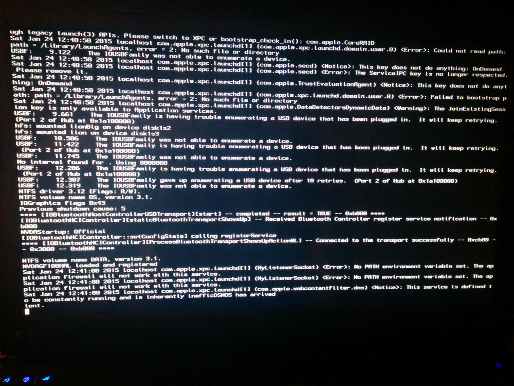

karlis90 Posted January 24, 2015 Posted January 24, 2015 Hi, I used this installer http://Olarila.com/forum/viewtopic.php?f=36&t=5009 , installed latest clover like here http://www.tonycrapx86.com/yosemite-desktop-guides/144426-how-install-os-x-yosemite-using-clover.html , copied all the files like in instructions (the Board-ID was already there Mac-FC02E91DDD3FA6A4, did not need to add anything), but i still get the black screen!! This is is the last screen. It stays like this for ~2 mins and then goes black... Can someone please give some advice?
oldnapalm Posted January 26, 2015 Author Posted January 26, 2015 If you used my files, the Board-ID in config.plist is Mac-942459F5819B171B, you need to add it in AppleGraphicsDevicePolicy. Mac-FC02E91DDD3FA6A4 is iMac Board-ID, you may use it to avoid black screen in first boot but I don't recommend keep using it after post install. -Guides and Tutorials HERE -Hackintosh Tutorial Database - HERE -The largest EFI folder collection for Hackintosh HERE -Support Olarila Vanilla Hackintosh by making a donation HERE -Professional Consulting for macOS Hackintosh since 2006 HERE
