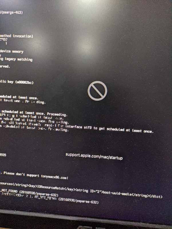

Unfortunately I tried with default BIOS and with Intel VGA as primary and with nVidia as primary VGA also and I'm using Olarila efi , but the same issue always as it's showing in the picture :

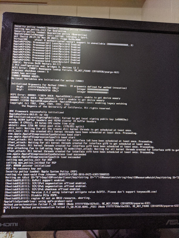

I booted now with only HDMI connected and Intel HD is set to primary in BIOS and I get this panic :
And after couple seconds it shows like this :
