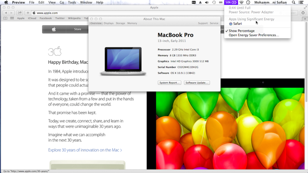

Here's MY DSTD File For Dell Vostro 3350 ( Hybird VGA ATI and Intel )
I took DSDT From Ubuntu OS then Patch Using DSDT Editor With :
DTGP
EHCI
FN KEYS
HDEF _DSM
HPET
IRQS
LPC
PNLF SB
RTC
SMBUS
Working Battery Icon
Sleeps
USB 3 dan 2
*For Wifi Card I replace with Atheros
