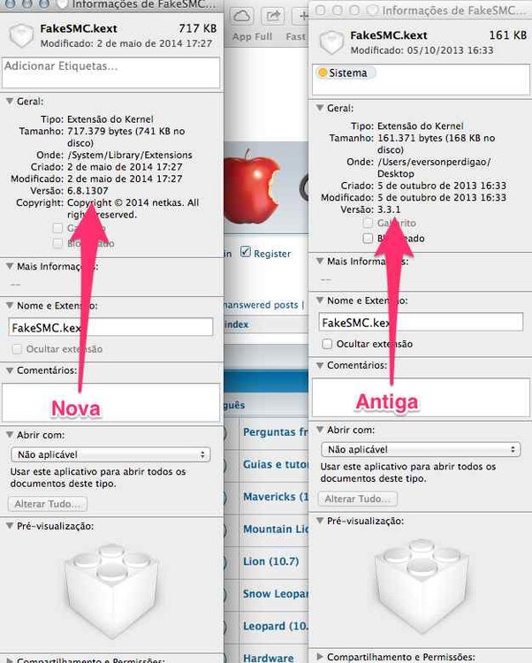

tenho esses logs:
May 6 10:35:56 localhost kernel[0]: SMC::smcReadKeyAction ERROR LsNM kSMCKeyNotFound(0x84) fKeyHashTable=0x0
May 6 10:35:56 localhost kernel[0]: SMC::smcGetLightshowVers ERROR: smcReadKey LsNM failed (kSMCKeyNotFound)
May 6 10:35:56 localhost kernel[0]: SMC::smcPublishLightshowVersion ERROR: smcGetLightshowVers failed (kSMCKeyNotFound)
May 6 10:35:56 localhost kernel[0]: SMC::smcInitHelper ERROR: smcPublishLightshowVersion failed (kSMCKeyNotFound)
May 6 10:35:56 localhost kernel[0]: SMC::smcInitHelper ERROR: MMIO regMap == NULL - fall back to old SMC mode
Tem alguma coisa com essa solução do tópico?
eu estou usando a flag dart=0, e o erro continua.
Atualizei a FakeSMC como vc falou pernacabeluda.
