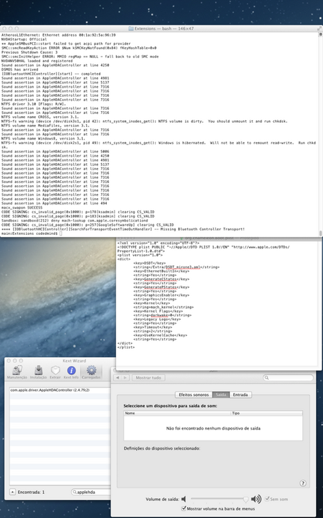

codedmind Posted October 18, 2013 Author Posted October 18, 2013 Sem som... o dmesg mostra isto ... Sound assertion in AppleHDAController at line 4981 Sound assertion in AppleHDAController at line 5137 Sound assertion in AppleHDAController at line 7316 Sound assertion in AppleHDAController at line 7316 Sound assertion in AppleHDAController at line 7316 Sound assertion in AppleHDAController at line 7316 Sound assertion in AppleHDAController at line 7316 Sound assertion in AppleHDAController at line 7316 Sound assertion in AppleHDAController at line 7316 Sound assertion in AppleHDAController at line 7316 Sound assertion in AppleHDAController at line 5006 Sound assertion in AppleHDAController at line 4250 Sound assertion in AppleHDAController at line 4981 Sound assertion in AppleHDAController at line 5137 Sound assertion in AppleHDAController at line 7316 Sound assertion in AppleHDAController at line 7316 Sound assertion in AppleHDAController at line 7316 Sound assertion in AppleHDAController at line 7316 Sound assertion in AppleHDAController at line 7316 Sound assertion in AppleHDAController at line 7316 Sound assertion in AppleHDAController at line 7316 Sound assertion in AppleHDAController at line 7316 Sound assertion in AppleHDAController at line 494

codedmind Posted October 19, 2013 Author Posted October 19, 2013 Viva, Mesmo resultado... sem som e mesmas linhas de sound assertion... Entretanto fiz upgrade para o 10.8.5 e surgem mais alguns erros no dmesg mas nao me parecem relacionados :/ SMC::smcReadKeyAction ERROR $Num kSMCKeyNotFound(0x84) fKeyHashTable=0x0 SMC::smcInitHelper ERROR: MMIO regMap == NULL - fall back to old SMC mode Sound assertion in AppleHDAController at line 4250 Sound assertion in AppleHDAController at line 4981 Sound assertion in AppleHDAController at line 5137 Sound assertion in AppleHDAController at line 7316 Sound assertion in AppleHDAController at line 7316 Sound assertion in AppleHDAController at line 7316 Sound assertion in AppleHDAController at line 7316 Sound assertion in AppleHDAController at line 7316 Sound assertion in AppleHDAController at line 7316 Sound assertion in AppleHDAController at line 7316 Sound assertion in AppleHDAController at line 7316 Sound assertion in AppleHDAController at line 5006 Sound assertion in AppleHDAController at line 4250 Sound assertion in AppleHDAController at line 4981 Sound assertion in AppleHDAController at line 5137 Sound assertion in AppleHDAController at line 7316 Sound assertion in AppleHDAController at line 7316 Sound assertion in AppleHDAController at line 7316 Sound assertion in AppleHDAController at line 7316 Sound assertion in AppleHDAController at line 7316 Sound assertion in AppleHDAController at line 7316 Sound assertion in AppleHDAController at line 7316 Sound assertion in AppleHDAController at line 7316 Sound assertion in AppleHDAController at line 494
Mirone Posted October 19, 2013 Posted October 19, 2013 testa essa: http://www.sendspace.com/file/44gb3b confirmar se a kext esta mesmo sendo carregada, me retornar com Printscreen de informações do sistema/Audio
Mirone Posted October 19, 2013 Posted October 19, 2013 não, a kext não esta sendo carregada. coloque o dsdt na raiz de sua partição e não na pasta extra e deixe como DSDT.aml e não mironedsdt. se estiver usando as flags npci=0x2000/3000 delete elas.

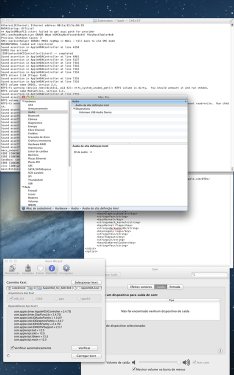

codedmind Posted October 19, 2013 Author Posted October 19, 2013 Fiz o que indicou mas nada ... Como confirmo que a esta ou nao sendo carregada? N\ao estou a usar nenhuma flag para o npci
Mirone Posted October 19, 2013 Posted October 19, 2013 use o kextwizard. Olhe se você não esta usando nenhuma AppleHDAdisabler em S/L/E.
codedmind Posted October 19, 2013 Author Posted October 19, 2013 com o kextwizard já tinha mostrado à pouco na imagem... ele tá carregado e é o unico applehda carregado.. nao tenho nenhum disable instalado
codedmind Posted October 19, 2013 Author Posted October 19, 2013 Sem erro... mas sem som codedmind$ sudo kextutil -l /System/Library/Extensions/AppleHDA.kext Password: No kernel file specified, using '/mach_kernel' main:Extensions codedmind$
