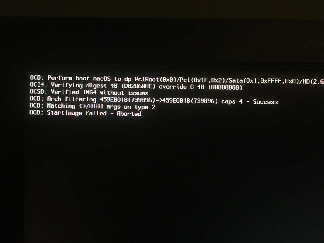

Hello Mald0n,
I want to use supported GPU in macOS next to RTX I'm using in Windows. However, with dual-GPU there is crash immediately after selection macOS from opencore. With single-GPU everything is working fine. I've tried to fix this by disabling RTX via methods from opencore manual, but none of them works for me. Could you help with DSDT? I've made two Send me packages with each card. I've donated you via PayPal and make that again if it's going to work :).Send me Mac-Pro_combined.7z

It get past OC, but it stuck here:
spacer.png Console is displayed on RTX, the output on GT710 is not available.
EDIT: Ok, it is working, I have to only disconnect display from RTX during boot! :)
However, if I plug WX4100 instead GT710, then I still get the same error from OC that I was receiving with old DSDT:

EDIT: Well, it's weird as f... Behavior is different each time and not consistent at all. Sometimes it hangs on OC, sometimes it boots to error with IOAPIC and rarely it boots to the desktop. All seems depending on previous state of boot, which boot option was selected last time, also if hardware was modified or which cable was connected.
I will do more testing and try to find some repeatable patterns.
