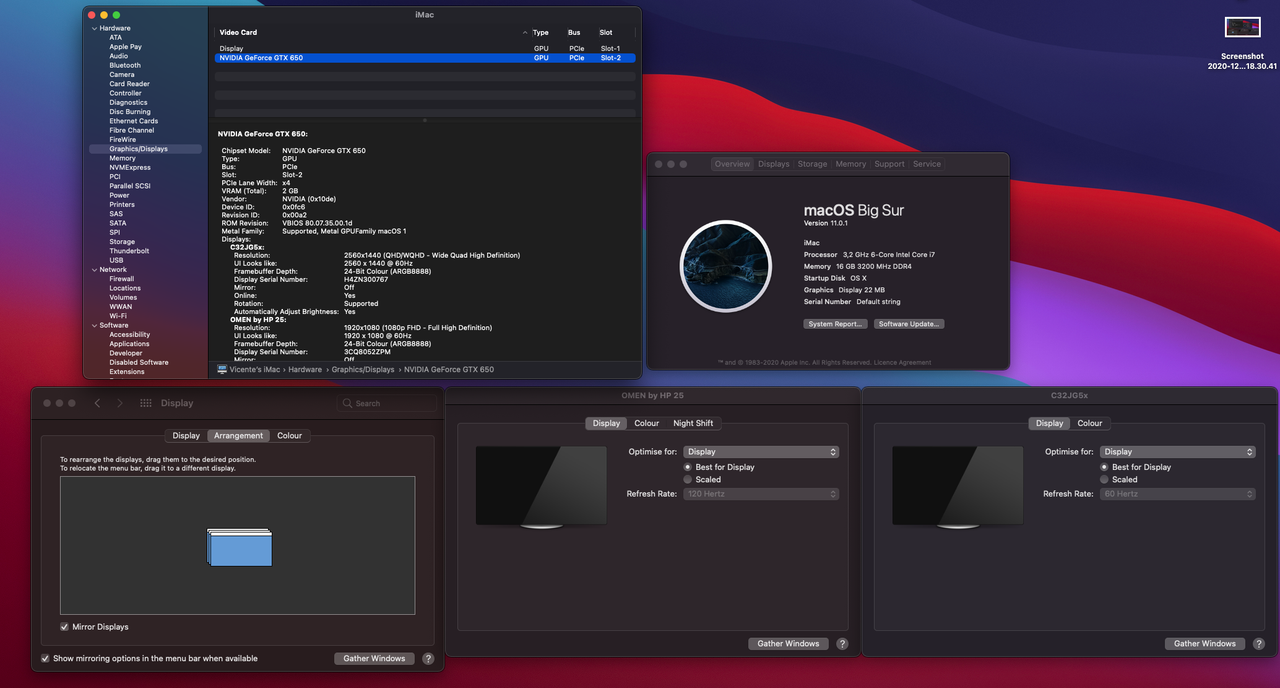

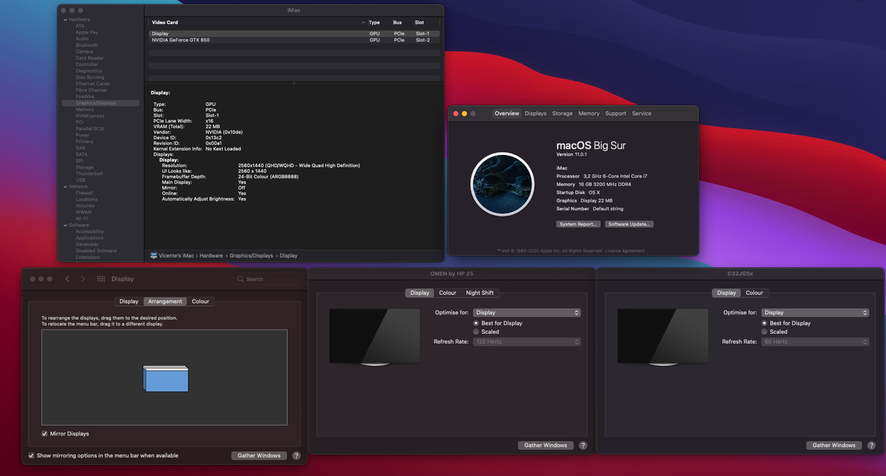

Hello MaLd0n,
I have Big Sur installed with OpenCore, everything seems to be working good except the graphics.
I have 2 graphics card on my PC:
PCI Slot1: GTX 970
PCI Slot2: GTX 650
I also have 2 monitors:
-HP OMEN 25 connected to GTX 650 by DVI.
-Samsung C32JG5x connected to both 650 (by HDMI) & 970 (by DP).
When I boot the hackintosh, it starts on PCI Slot1 DP, verbose process finish and stays on verbose.
Both DVI & HDMI on 650 are working fine, but OS X detects 3 displays, not 2.
The problem is I need to mirror displays so I can see the main one, the DVI and HDMI displays connected to 650 are not the principal display.
Do you know what can I do to have just 650 detected so I have only 2 displays not 3? Maybe disable PCI Slot1?
I attach some screenshots for further information and RunMe.zip.
Thanks in advance for your help!!
