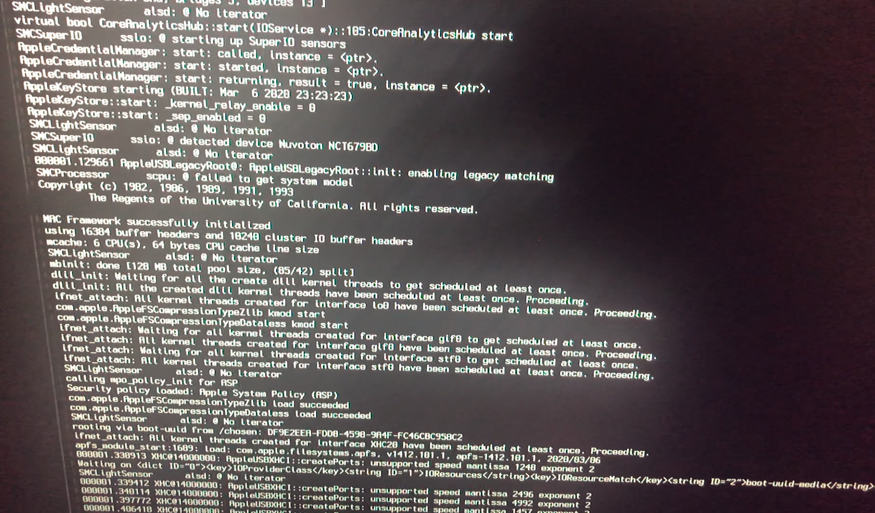

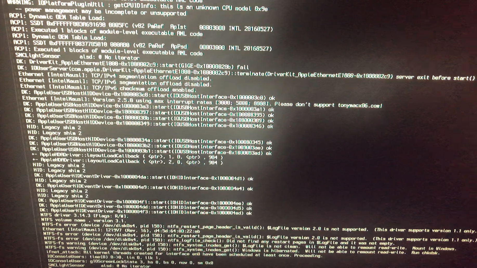

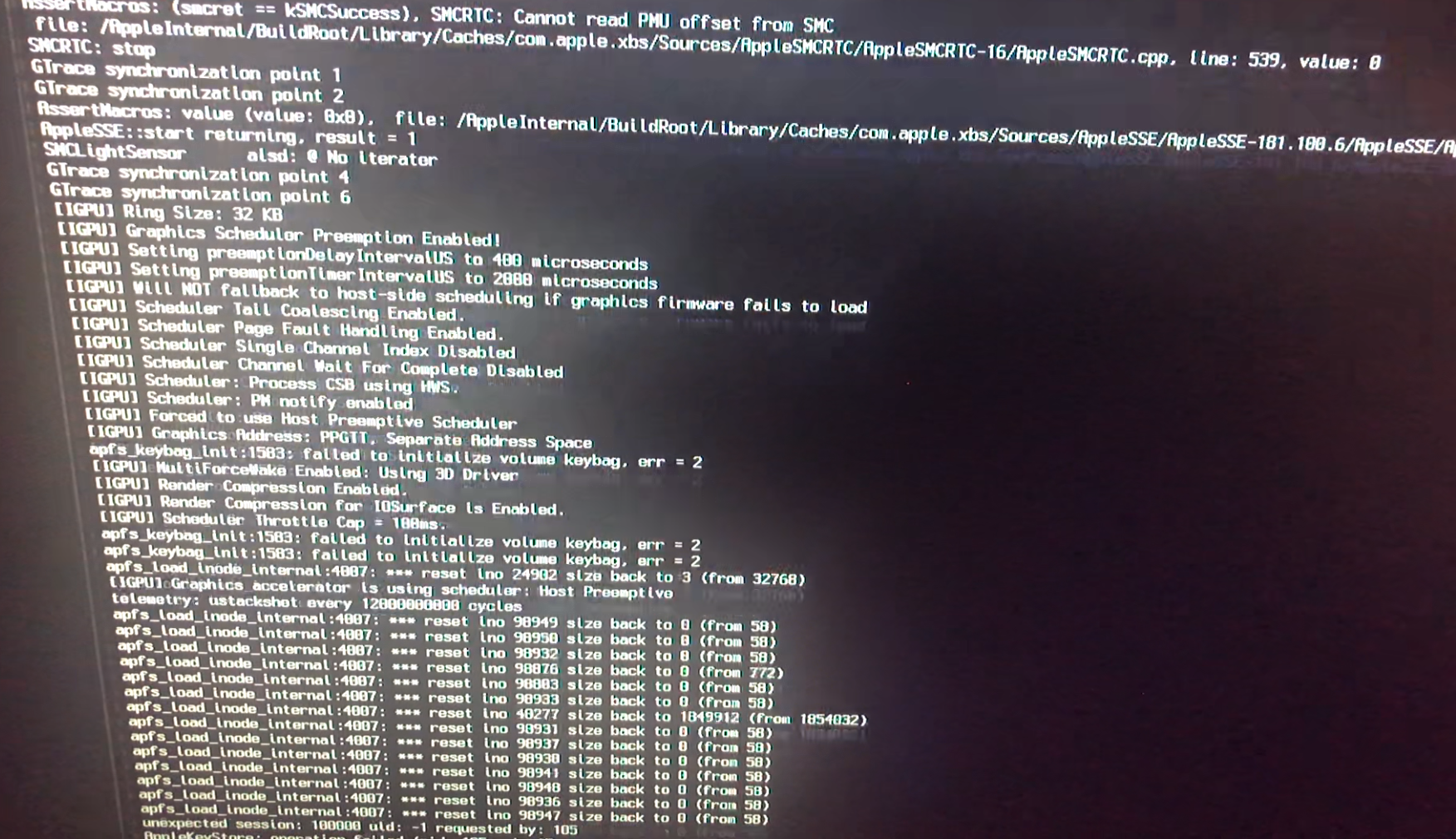

IamPol Posted May 15, 2020 Posted May 15, 2020 (edited) Hello everyone, I recently upgraded my pc and decided to update my hackintosh with the new catalina. However since then, it has been only a nightmare. My problem is that I can't manage to make the intel graphics work properly. I have tried many guides out there but they all end up with the same result: kernel panic or stuck at boot. I can boot into mac by injecting intel and applying a 0x12345678 fakeid and 0x59120000 as ig-platform-id but then I get many graphic bugs and the os does not feel smooth. My hardware is: Asus ROG z390 Intel i5 9600k I have an nvidia GPU too, which i use with ubuntu, but I dont have any cable connected to it and the bios is set for CPU graphics with 64MB preallocated DVMT. What I have tried: https://hackintosh.gitbook.io/-r-hackintosh-vanilla-desktop-guide/config.plist-per-hardware/coffee-lake But i get the SMCSuperIO ssio: @ detected device Nuvoton NCT679BD which is supposed to be fixed by the RTC Bug patch in the config.plist I have also tried removing that and using the original config.plist but then I get the buggy-slow graphics. Then I tried to set the igpu in the devices, but then I just get a black screen after boot. Here is my current config.plist and some screens of the black-screen boot. can anyone help me? C config.zip Edited May 15, 2020 by IamPol
