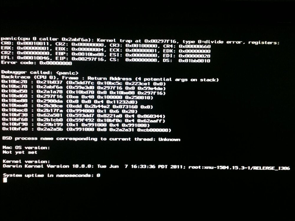

codorna Posted October 24, 2011 Posted October 24, 2011 Gostaria de saber como instalar leopard snow na placa asus p8h61-m le com Sandy Bridge pois nem o Everest consegue retirar o DSDT pois da erro.
oldnapalm Posted October 24, 2011 Posted October 24, 2011 A instalação não depende de DSDT. Use um CD de boot compatível com Sandy Bridge (com kernel 10.8.0 como o HackBoot v7 ou com kernel modificado como o OSX86 ModCD). -Guides and Tutorials HERE -Hackintosh Tutorial Database - HERE -The largest EFI folder collection for Hackintosh HERE -Support Olarila Vanilla Hackintosh by making a donation HERE -Professional Consulting for macOS Hackintosh since 2006 HERE
codorna Posted October 28, 2011 Posted October 28, 2011 O que devo fazer para corrigir este erro, mao deu nem para iniciar o sistema para instalacao
Cassio Posted October 28, 2011 Posted October 28, 2011 Faça um "load optimized defaults" no BIOS e mude SATA de IDE para AHCI. Se não funcionar tente outro CD de boot. OSX86 ModCD iBoot -Guides and Tutorials HERE -Hackintosh Tutorial Database - HERE -The largest EFI folder collection for Hackintosh HERE -Support Olarila Vanilla Hackintosh by making a donation HERE -Professional Consulting for macOS Hackintosh since 2006 HERE
