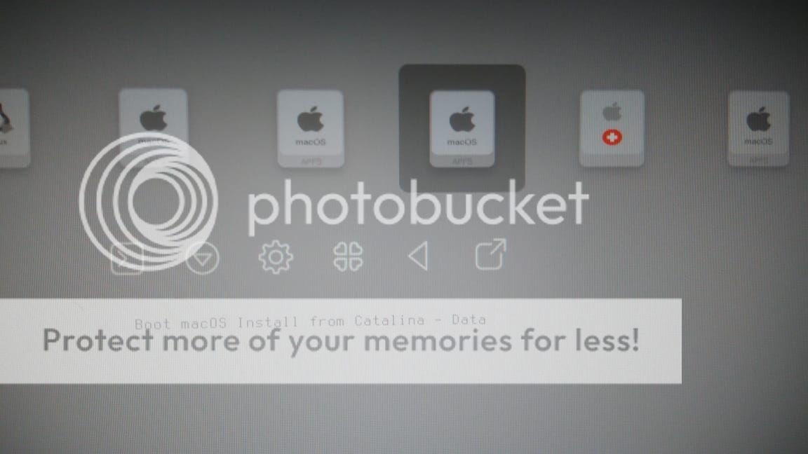

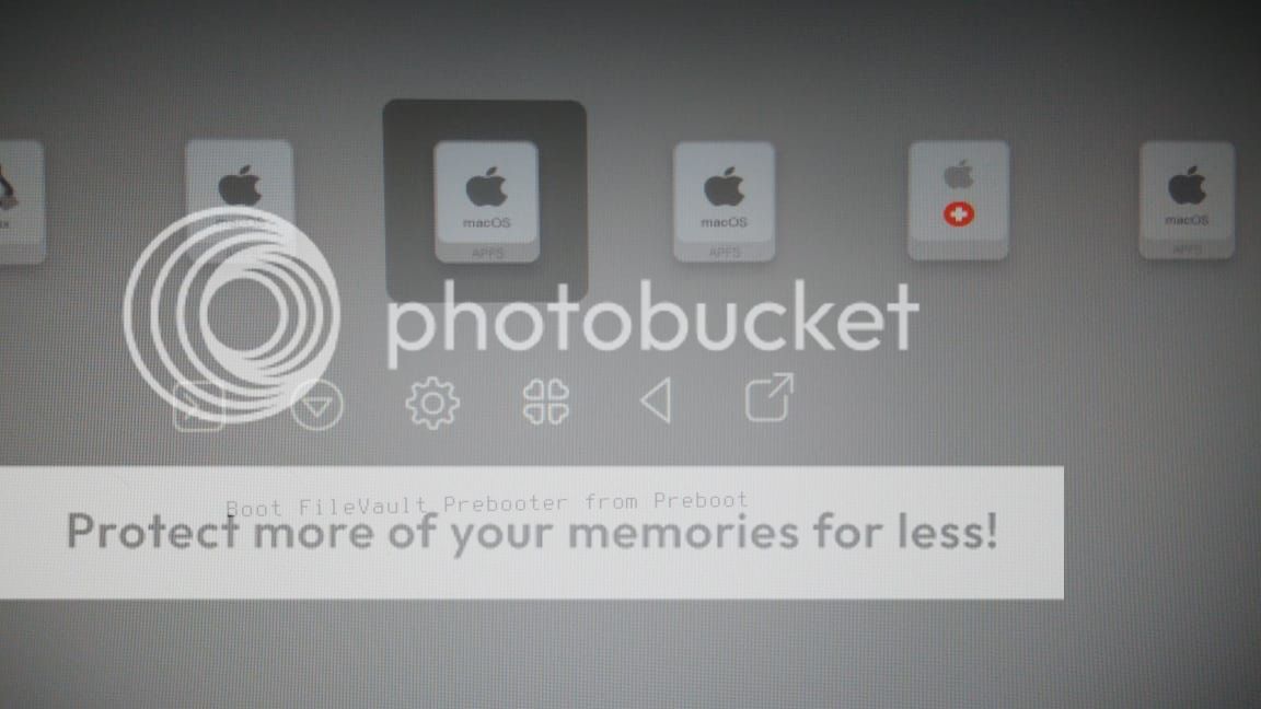

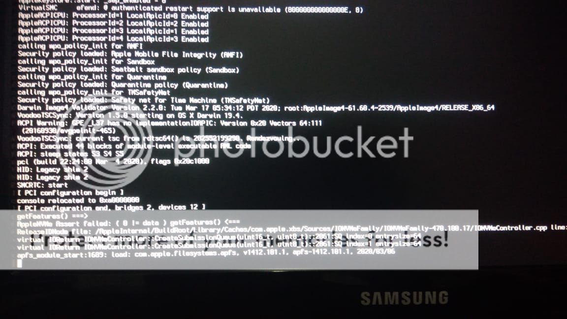

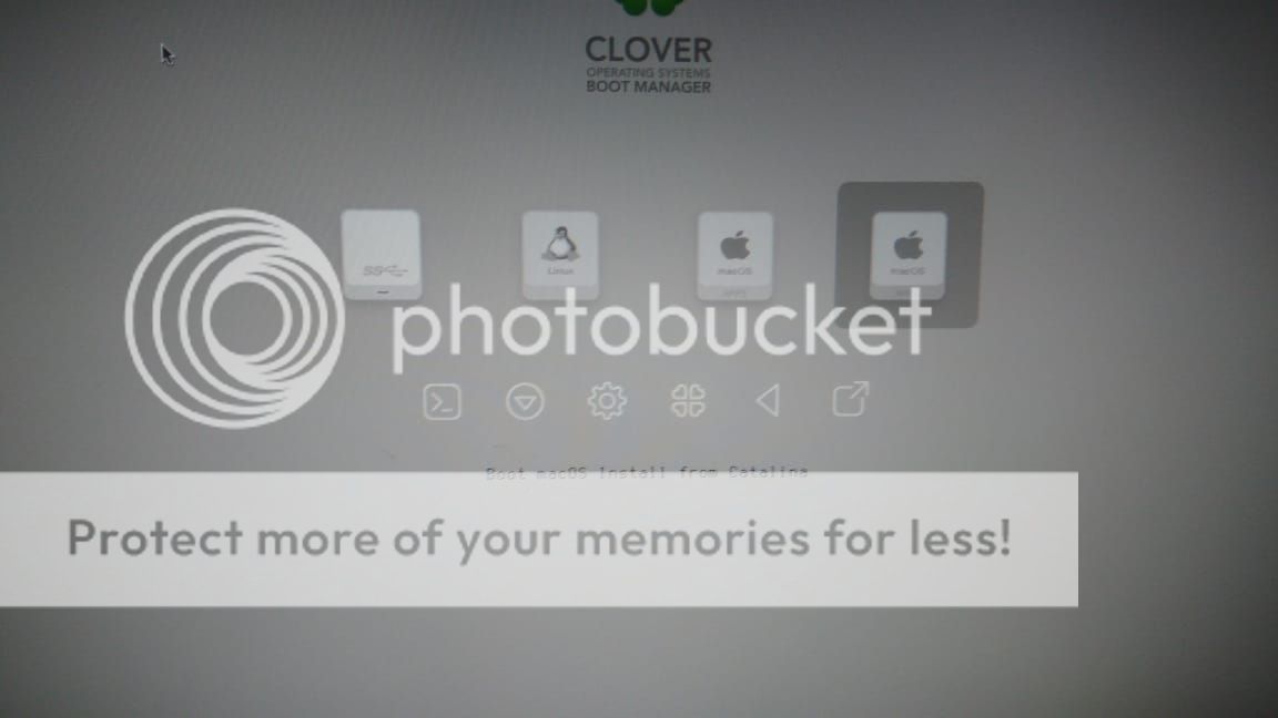

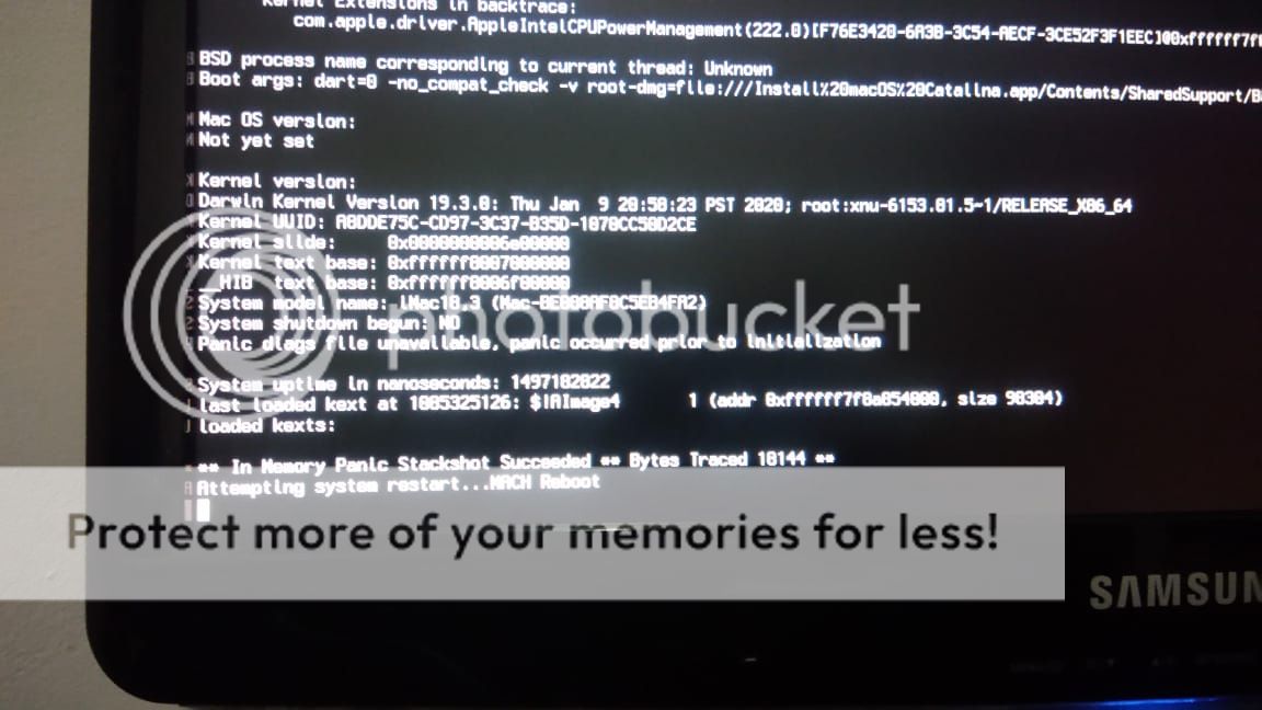

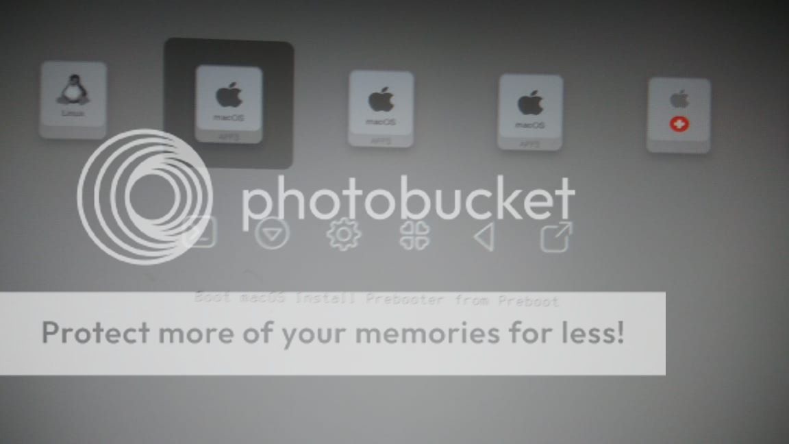

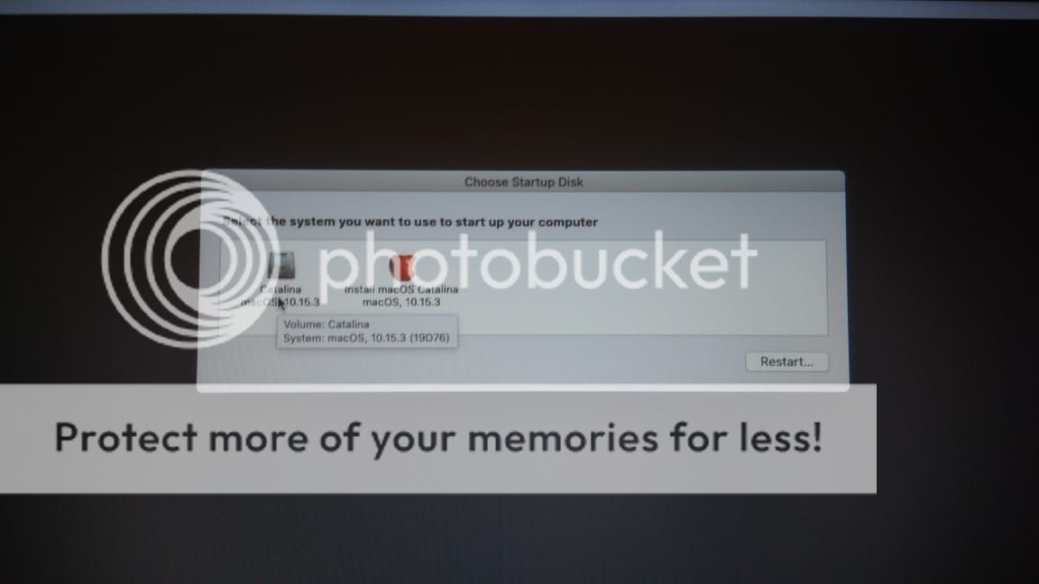

Therefore, I was able to start the installation that always stopped with 2 minutes left for completion. I discovered that I needed to manually restart to proceed with the process, I also discovered that the partition table needs to be APFS and not journaling. From there I came to the following screens.
I chose this option
I get to here and freezes, then restart again and I have the screens below.
I have a doubt which one to start with and the most I got was until now

MaLd0n Replace the clover folder in EFI, and now does not boot the installation
use nullcpupm
NullCPUPowerManagement.kext.zip
Hello MaLd0n, passing a feedback here, I added the NullCPUPowerManagement.kext drive in the other folder and I was not successful, so I took a position,
 I took the config.plist and DSDT.aml from the clover folder you sent me and put it in my old clover folder, I also kept the SSDT-EC.aml file in the folder
