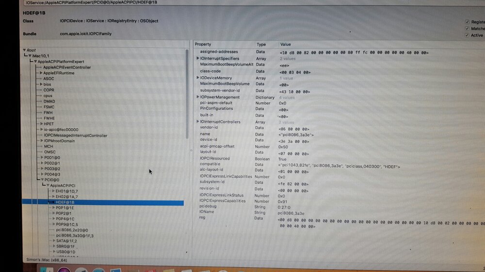

however I have not yet found a solution for the sound to work. my sound-device should be alc1200 (from Asus p5ql-em), and I tried injecting layout-id 1,2,3,5,7,11,12,13 , none of them worked. the only way the computer would boot into HS is if the layout-id is empty, any other number it would end with the error message 'time out with IOHDADEVICE........"
I have also tried fixed option and suggestions from https://hackintosher.com/guides/get-hackintosh-audio-working/ but neither have not worked.

thanks for the dsdt, I put it in the refi/clover/acpi/patch, and loaded it in clover startup, however it is the same timeout iohdadevice error. I also tried replacing applehda in extension with older (alc1200) one from internet back in 2009-12, then the Mac would boot with both bios.aml/your dsdt.aml, but neither show any sound output device. I tried Toleda patch also, but no luck still. it seems like applehda is the problem. I have put the vanilla HS applehda back in extensions.
from your website, there are dsdt for p5ql-e and p5q-em which are similar to mine, unfortunately I don't know enough to put the the code into test.
I hope by fixing the hackintosh it would keep my hardware alive for a few more years, that would be amazing.
I have attached my latest zip, please let me know if you have further ideas that we can try out to fix the problem.
many thanks.

I copied the vanilla applehda from your Olarila HighSierra USB into S/L/E. then I tried to inject layout-id with 1/2/3/4/5/6/7/11, still no sound output on anyone of them. I have attached my applehda in zip.
is there any other info/data that might help?

also please see my clover audio screenshot, it has 2 controller, is that correct?
Added in 2 minutes 58 seconds:
and this is the error message from my bios.aml + id layout 1
Added in 13 minutes 12 seconds:
correction: i think i have been using your dsdt + inject layout 1 to 11, not bios.aml.
AppleHDA.kext.zip
i have also attached my linux codec dump, and my HDEF@1B which i think you would have saw from the zip.
i followed the reddit vanilla applehda guide, still no luck :( i have been trying mostly layout 1 & 7.
