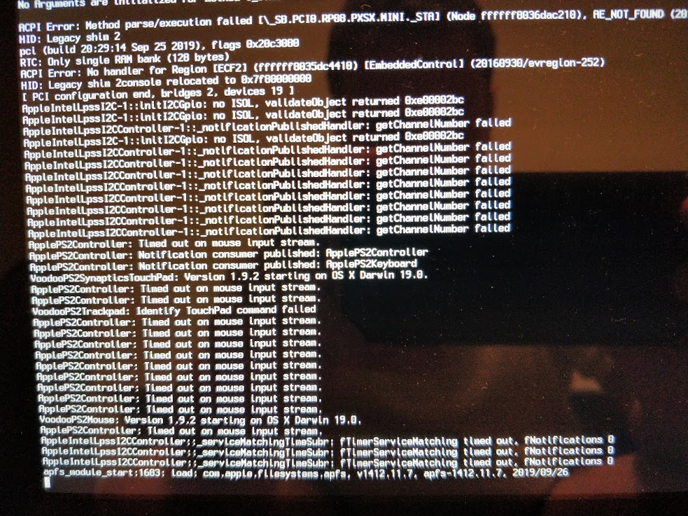

All that work...and now i cant boot...I tried installing ACIPBatterymanager.kext...and she wont boot. UGH. Any ideas? How do I boot without that kext?
Added in 1 minute 40 seconds:
I should have left it alone
Added in 2 minutes 55 seconds:
It bootedTook forever.........i now have 100% batt with acpibattmanager. I will try removing smcbatt manager
