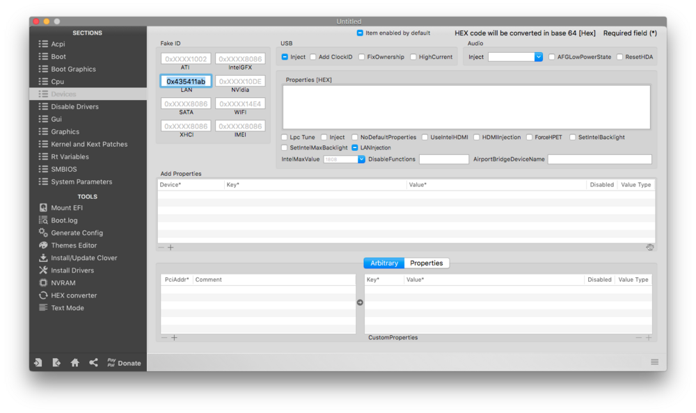

Sorry that didn't work. Found this kext:
https://www.insanelymac.com/forum/files/file/241-marvell-88e8056-for-mavericks-1093/
and installed it with Kext Utility. Yes the Ethernet appears to work (the port LEDs are on) but now the nVidia installation is broken. I can only boot with nv_disable=1 flag. How can I repair the nVidia installation?

thank you for your reply, Mald0n. I will try version 1.8 (version 1.9 does not support Mavericks) and report back. Which ioreg version should I use with 10.9.5?
https://Olarila.com/files/Utils/IORegistryExplorer.zip
