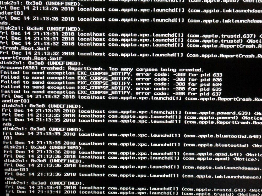

Pingguo Posted February 6, 2019 Posted February 6, 2019 Hi MaLd0n! I followed this guide for the SandyBridge systems, using your High Sierra image. I'm happy with the results because the Sleep functionallity works correctly, the GPU is recognized and works with Display Port and DVI with dual screens, etc. But I have some problems that I have no idea how to fix (I'm a kinda of noob). I have random freezes in the OS, sometimes they doesn't appears for days, sometimes I can have 2 or 3 in a day, but they are very randomly. I just have to press the reset button in the case, the system is switching off (it doesn't reboot) and press the switch on button again. Sometimes I have to press the switch on button 3 or 4 times to start the computer, other times in the first push it starts inmediately. Another problem is that I've tried to update the system but it seems that never ends, in verbose mode I can see many "EXC_CORPSE_NOTIFY" exceptions like in the screenshot. After some hours trying to finish I had to reboot the computer and when Clover starts appears a new icon, if I try to start from that new icon the update will restart again with the same results. I read that in a succesful update process those icons dissapear form the Clover menu, but in my case they remains there (I have 2 of them from 2 different updates). And finally seems that USB 3.0 doesn't work, probably it can't work because this motherboard is old, so I can live without it, but the USB in the front side of the case also doesn't work with any USB device, 2.0 or 1.0. I used the DSDT included in the Clover Folder for the 6 Series, but I don't know if I should use the Fine Tune DSDT in the Post Installation to fix this issues. I'm using the iMac12,2 SMBIOS. I'll appreciate really much your help. Regards.
Administrators MaLd0n Posted February 6, 2019 Author Administrators Posted February 6, 2019 Hi MaLd0n! I followed this guide for the SandyBridge systems, using your High Sierra image. I'm happy with the results because the Sleep functionallity works correctly, the GPU is recognized and works with Display Port and DVI with dual screens, etc. But I have some problems that I have no idea how to fix (I'm a kinda of noob). post ur files here --Run_Me RunMe.app -Guides and Tutorials HERE -Hackintosh Tutorial Database - HERE -The largest EFI folder collection for Hackintosh HERE -Support Olarila Vanilla Hackintosh by making a donation HERE -Professional Hackintosh Support since 2006 HERE
Pingguo Posted February 6, 2019 Posted February 6, 2019 Here it is. Thank you! Send me iMac-de-Kenmitsu.zip
Administrators MaLd0n Posted February 6, 2019 Author Administrators Posted February 6, 2019 Here it is. Thank you! CLOVER.zip generate a correct ssdt pm https://Olarila.com/files/Utils/ssdtPRGen.command.zip -Guides and Tutorials HERE -Hackintosh Tutorial Database - HERE -The largest EFI folder collection for Hackintosh HERE -Support Olarila Vanilla Hackintosh by making a donation HERE -Professional Hackintosh Support since 2006 HERE
