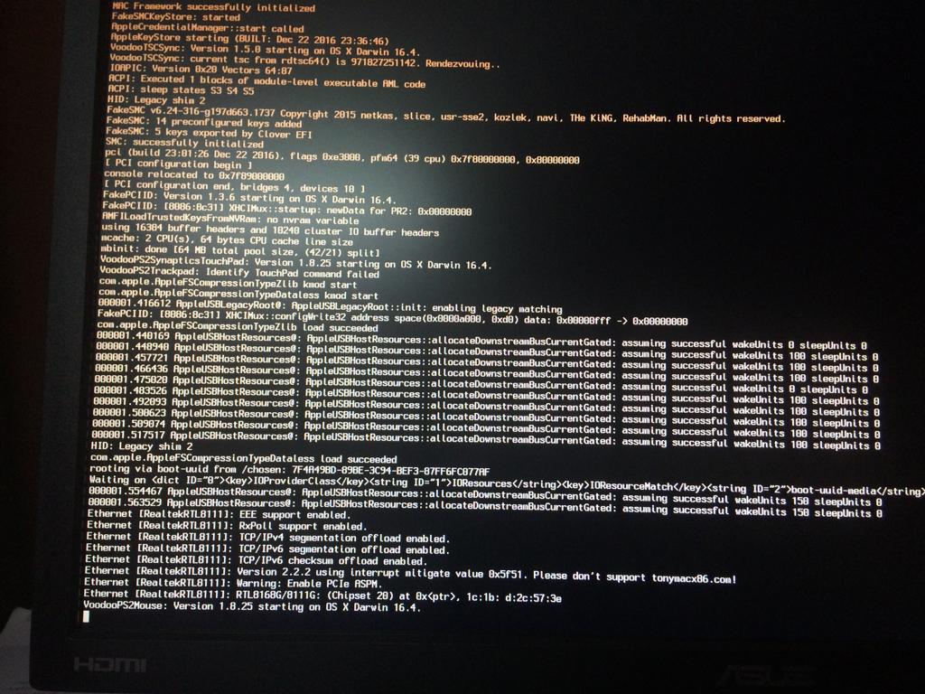

I replaced files in my USB with yours as instructed. On booting from the USB the screen stops at:
VoodooPS2Mouse: Version 1.8.25 starting on OS X Darwin
I waited to see what would happen and I got garbled text on the screen and the No Entry sign in the center of the screen. How do I overcome this?

[ref]MaLd0n[/ref], I have a HFSExplorer in Windows and I understood what L/E and S/L/E is. It is Library/Extension and System/Library/Extension folders that have *.kext in them. So how do I remove or block so many of them? I found the VoodooPS2Controller.kext that was stopping my progress into the install in the clover/kexts/others folder and removed it. I am doing all this on one PC so I have to boot and reboot so many times.
[ref]hackadventure[/ref], if u have hackintosh kexts in l/e or s/l/e, block kexts in clover/kexts/other in clover, press barspace in clover boot screen
[ref]MaLd0n[/ref], I changed the contents of clover folder with the one you provided at the beginning of this post i.e., on pg one. So on press barspace I get the kexts that is set. So, according to your instructions I just press barspace in clover screen and unselect the ones pre-chosen, right? There is an option to boot without selected kexts. I even chose that option but I still could not get to the install screen.
boot into system and remove
the thing is I am still struggling with getting to the install screen on booting from USB. Even after removing kexts from /L/E folder on USB and the clover/kexts/others folder. It still comes to the
VoodooPS2Mouse:
part and stops.
