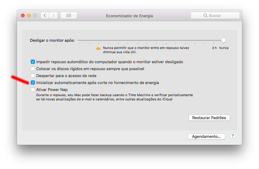

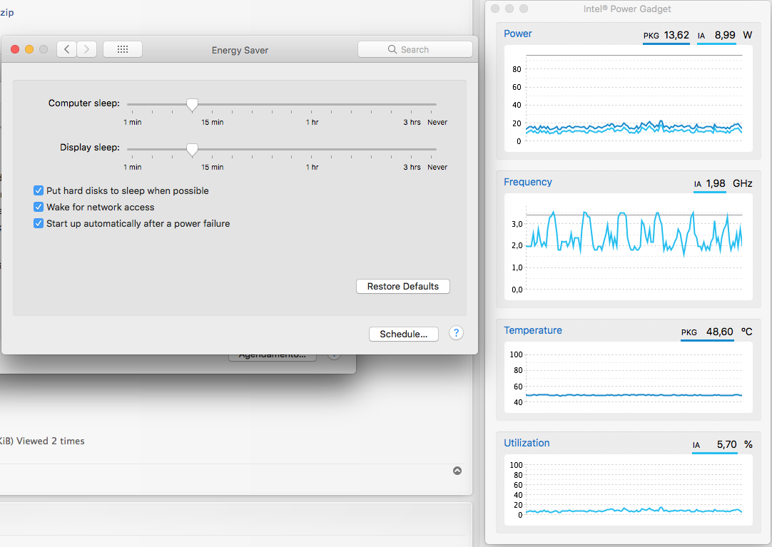

disable hibernate, use it in all hacks
disablehibernate.command.zip
try
check if wake from usb work
