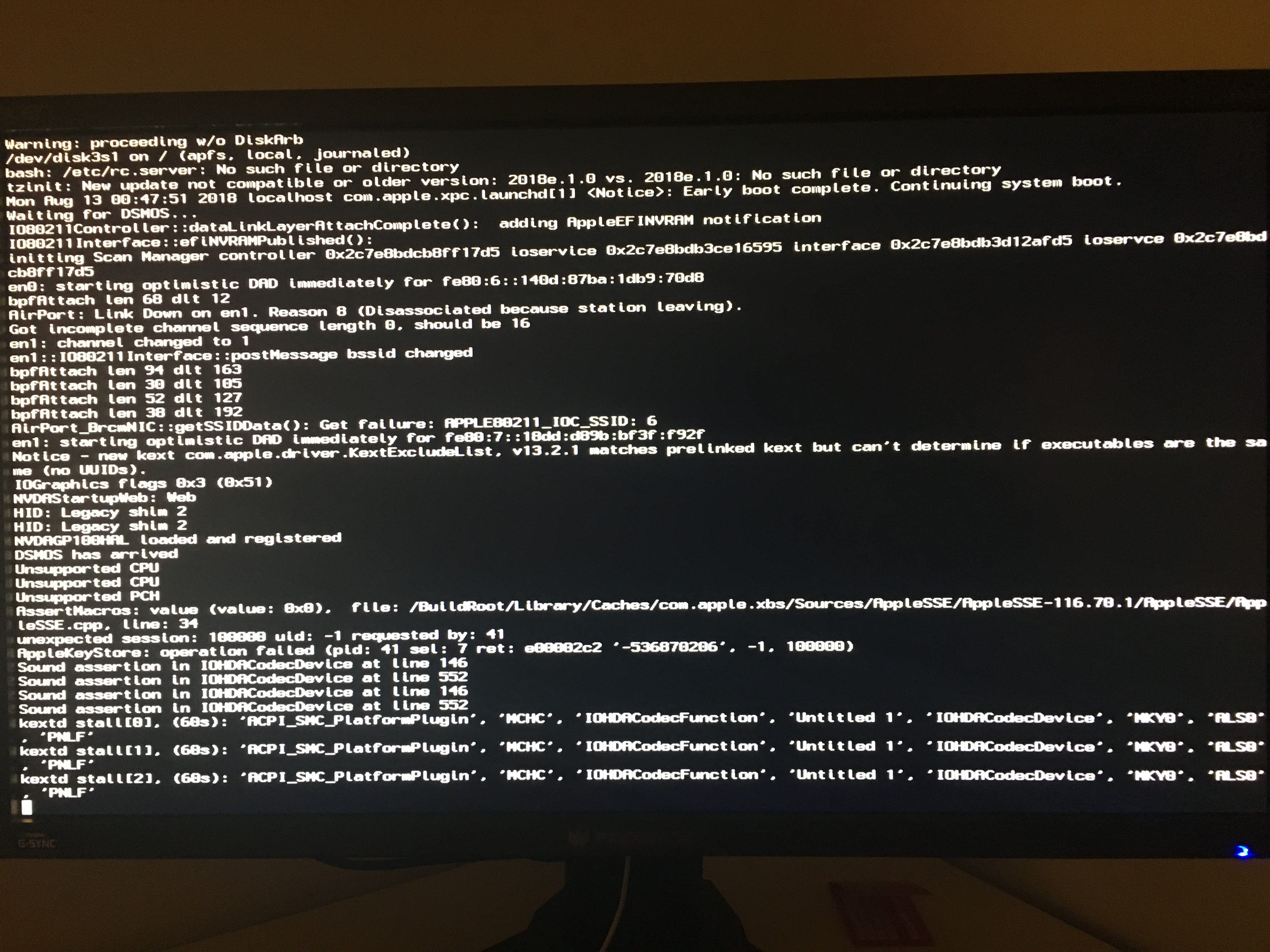

robert1967 Posted August 12, 2018 Posted August 12, 2018 Hi, Here Is the foto: I recovered my hack and followed a lot of different Tutorials and scripts. When i dont use appleALC Clover injection my DisplayPort Sound works . When i try different solutions it stucks at boot.
Administrators MaLd0n Posted August 12, 2018 Author Administrators Posted August 12, 2018 Hi MaldOn, I am sending you Send me file for my new iMac14,2 Board is Asrock H91m-s1 Plus Processor Intel i3-4150 Video card Nvidia Geforce Gt 710 2gb 12 Gb of memory Can you also setup config.plist for me. Thank you send me files -Guides and Tutorials HERE -Hackintosh Tutorial Database - HERE -The largest EFI folder collection for Hackintosh HERE -Support Olarila Vanilla Hackintosh by making a donation HERE -Professional Hackintosh Support since 2006 HERE
Administrators MaLd0n Posted August 12, 2018 Author Administrators Posted August 12, 2018 Hi, Here Is the foto: I recovered my hack and followed a lot of different Tutorials and scripts. When i dont use appleALC Clover injection my DisplayPort Sound works . When i try different solutions it stucks at boot. disable hdmi patch with flag -Guides and Tutorials HERE -Hackintosh Tutorial Database - HERE -The largest EFI folder collection for Hackintosh HERE -Support Olarila Vanilla Hackintosh by making a donation HERE -Professional Hackintosh Support since 2006 HERE
robert1967 Posted August 12, 2018 Posted August 12, 2018 hi, is nv_disable=1 the right flag to disable it? attached is my config. config2.plist.zip
Administrators MaLd0n Posted August 12, 2018 Author Administrators Posted August 12, 2018 hi, is nv_disable=1 the right flag to disable it? attached is my config. Attachments check all here https://github.com/acidanthera/WhateverGreen -Guides and Tutorials HERE -Hackintosh Tutorial Database - HERE -The largest EFI folder collection for Hackintosh HERE -Support Olarila Vanilla Hackintosh by making a donation HERE -Professional Hackintosh Support since 2006 HERE
