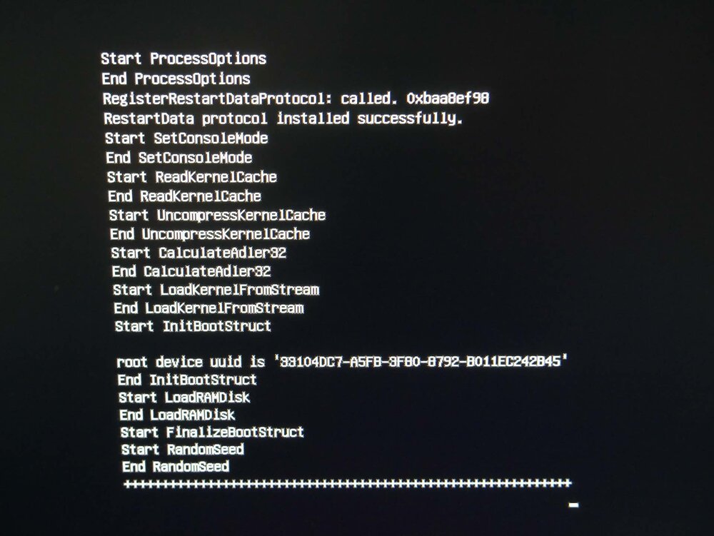

mine is stuck on boot during install.
(I know how to do this stuff, as i did my other laptop, an acer e15. Which I ran into bumps but I was able to manage to get it working.)
but this one here it boots to options, then after selecting boot from install, it starts loading the first very part and stays stuck there.
I waited for hours and nothing happened.
anyone else with issues like this on a 330s hardware?

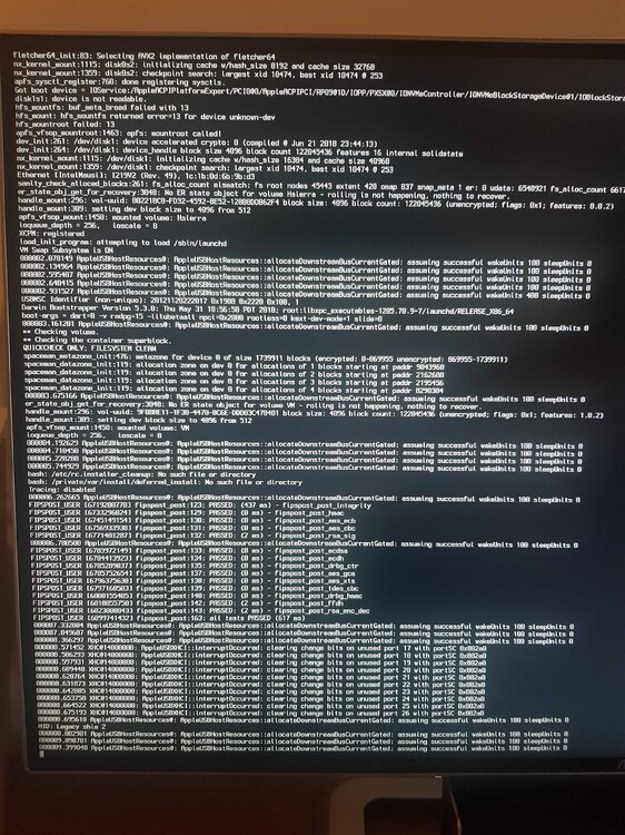

Hey sorry for the delay, works stuff kept me really busy.
So, here it is.
I read online it has to do with ram. However, my laptops ram its soldered, so I don't think can move it anywhere. There's got be a workaround.
I tried the following images:
10.13.2
10.13.6
10.14.6 Beta
I tried with the stock clover and then with the clover folder pre install from laptop 100.200.300 download folder.
It was a pain in the back to access the hfs files under ubuntu :lol:
I keep getting the same error over and over.
I notice some people successfully installed on ideapads 320's
use OsxAptioFixDrv-64.efi and EmuVariableUefi-64.efi instead aptiomemoryfix
Im not 100% sure on how to go about this.
On linux I can't see the mounted EFI, only the other folders once I mount the usb.
On windows, it doesn't even recognize the usb img on it as it ask if I want to format it.
I don't have access to mac.
I have either, linux or windows right now.
What would be the best way to replace the files needed? Is there any other *raw* iso with those specific files loaded? Or, is there a way I can select them on boot install?
just mount EFI in windows system and replace file ;)
