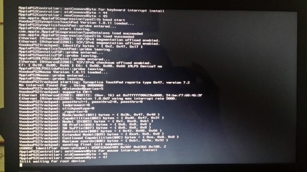

emanur9 Posted November 7, 2014 Author Posted November 7, 2014 Hello everyone, I downloaded the image from your website, I added the image to the memory stick DiskImage (win) and then I restarted the PC. I got to the screen where I can choose whether to start the installation with usb or start with windows or choose other settings. I choose to insallare mac os x usb. after a few seconds that run all the lines of mac os the screen goes black and nothing happens. I also tried in verbose mode but same result. I wanted to see some flags? I need to set something else before starting to usb? thanks to all
artur-pt Posted November 7, 2014 Posted November 7, 2014 hello must start to read .. that is urgent .. http://Olarila.com/forum/viewtopic.php?f=36&t=5006 and post all info u can .. with that kind of post .. we are good .. no magicians .. to guess i'm 99% sure ur graphics are incompatible... good hack PB Easy Note TM 86 - i5 430 M - H55M - Ram - 6 GB - Alc272 - Radeon HD 5470 512 QE/CI Lenovo G500 - i5 3230m - HM77 - Ram - 8 GB - Conexant audio - HD 4000 My OS X Files
emanur9 Posted November 7, 2014 Author Posted November 7, 2014 guys help me .. I was able to start the installation, I also created the partition but unfortunately I had the charger plugged in and then pc off. I rebooted but now I can not restart the installation. I get this message: missing bluetooth controller carry. what do I do? possible that the image of the USB is corrupt?
artur-pt Posted November 7, 2014 Posted November 7, 2014 hello usually is graphics .. see in guide what to do.. http://Olarila.com/forum/viewtopic.php?f=35&t=5005 good hack PB Easy Note TM 86 - i5 430 M - H55M - Ram - 6 GB - Alc272 - Radeon HD 5470 512 QE/CI Lenovo G500 - i5 3230m - HM77 - Ram - 8 GB - Conexant audio - HD 4000 My OS X Files

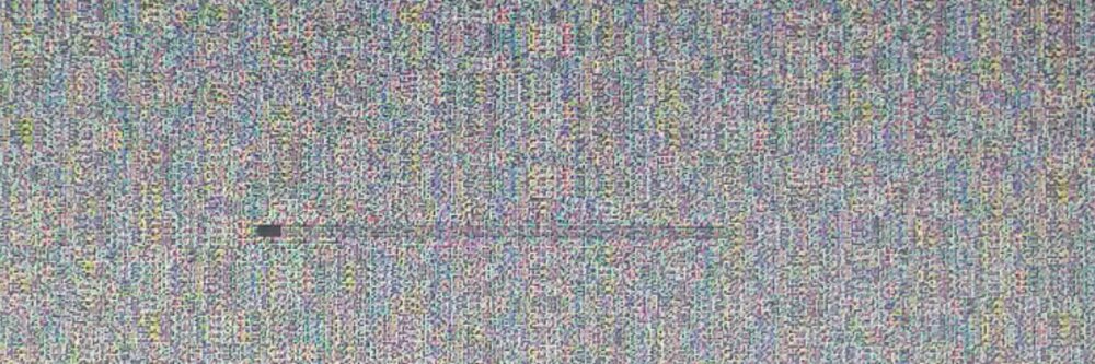

emanur9 Posted November 13, 2014 Author Posted November 13, 2014 hello, I managed to do everything. Now I have a problem. I installed the patch for the graphics card. all right at the beginning. now I can not do more because the video becomes the start of many colors and does not go ahead. I can do perfectly access with -x (I also use -v NCPI = 0x2000 and kext-dev-mode = 1) how should I do?
