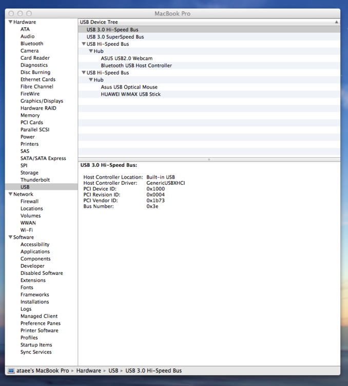

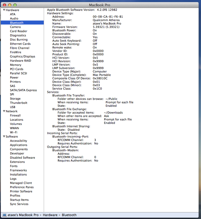

ramtin Posted April 4, 2014 Author Posted April 4, 2014 hello the bt is compatible ? i don't know what is ur bt ? it already works in mac os x ? what is the dev id and vendor id of the bt ? what makes the bt works is kext.. not the dsdt good hack hello dude yes that was worked in mountain lion . i had moving files from my phones to laptop via bluetooth as well. please check the screenshot for ven id and dev id.. i take screenshot from windows device manager too. the new issue is there : USB3 is not working agan. i just use shut down and today i see the hdd do not working . i re installed the kext again ( plus clean the kext cache ) and returned back and worked just for 20 minutes then usb3 is fucked again. its not stable and i must re install the kext before use . please solve this issue . i take screenshot. thanks artur you are very kindness . bt.jpg.zip
