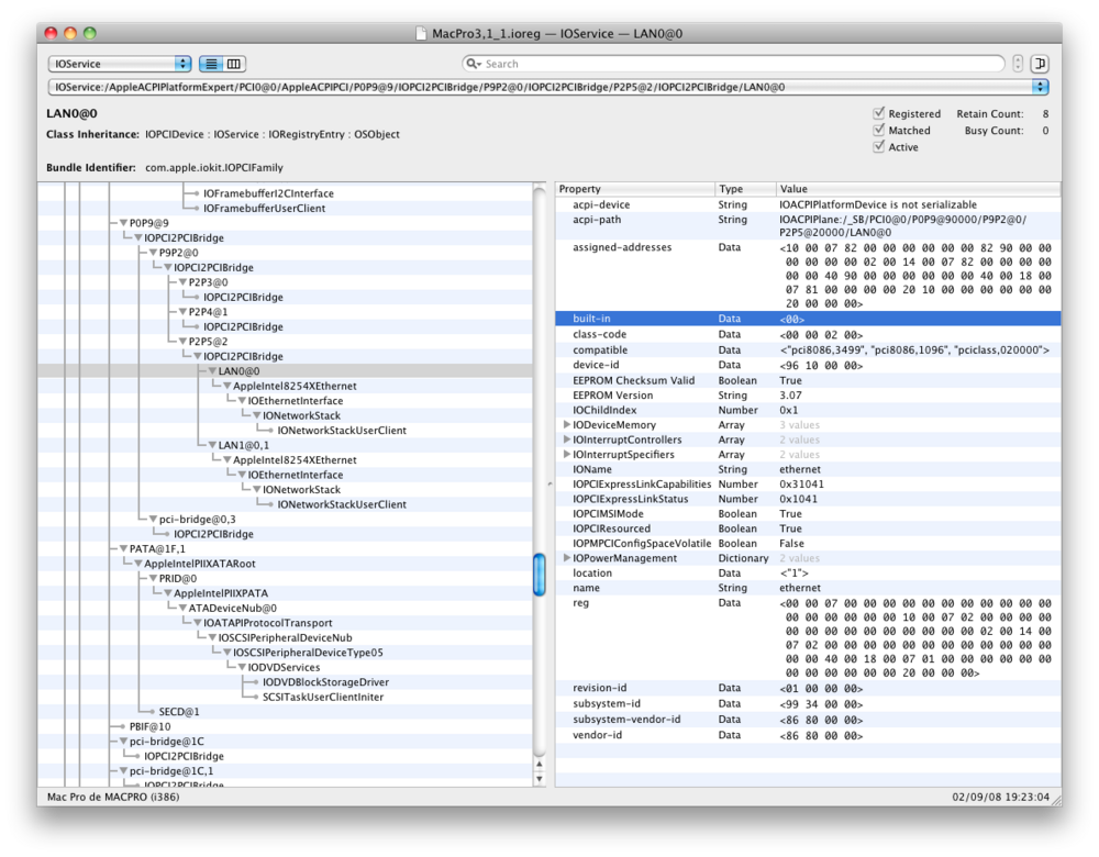

my patches are based on a Mac Real ioreg
28977321_Capturadetela2011-08-19s22_44_36.thumb.png.45b1891ee3920d8a640da9e24f45df86.png

Ok thank for your screen capture
but what does is it for "built-in 0x00 or 0x01"?
why don't we just remove those lines if it is not important?
