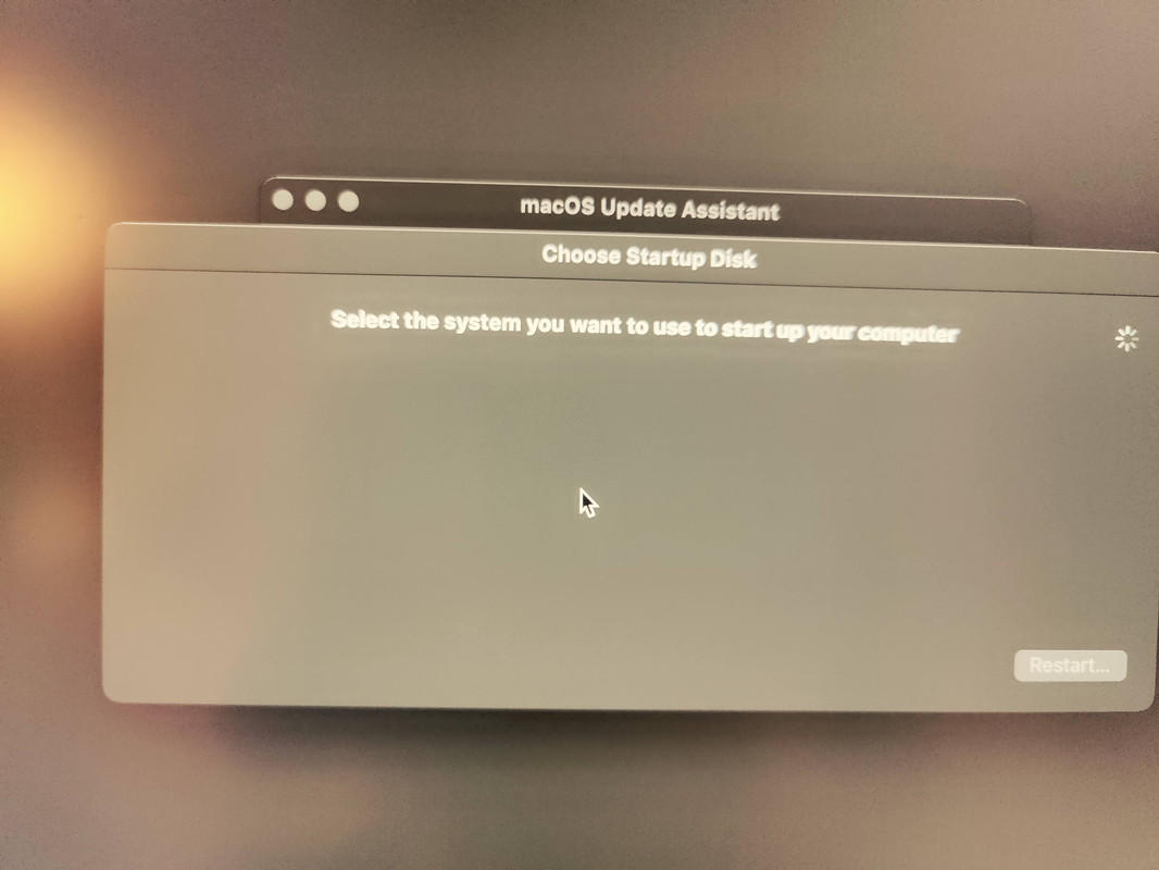

this is what happens. Maybe the install doesn't finish correctly?
  1. create USB drive to install macos
  2. add appropriate /EFI files to USB drive
  3. boot from USB drive and install macos to osx-monterey (at around 12 minutes to go, it quits and reboots)
  4. boot from target drive (osx-monterey)
  5. "macOS Update Assistant" prompts "A required firmware update could not be installed." which just press "OK"
  6. "macOS Update Assistant" prompts "Select the system you want to use to start up your computer"
Here At the last step, I expect to see my target drive, osx-monterey, but it's not there. Just an empty list.
So, the question is, did the install fail? Is this what I should expect to see when the install is done?

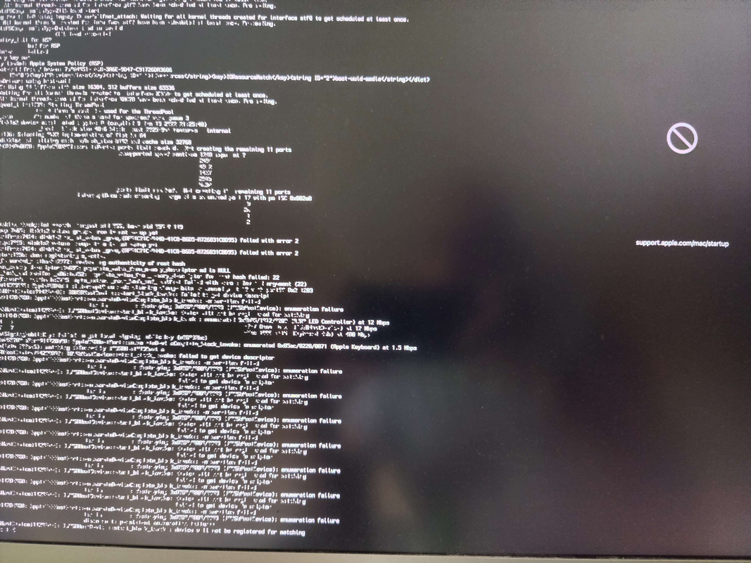

I used the one for cofeeLake and got this error. it's jumbled and I can't make it out:2022-05-30-13-51-46.jpg
Did I err?
