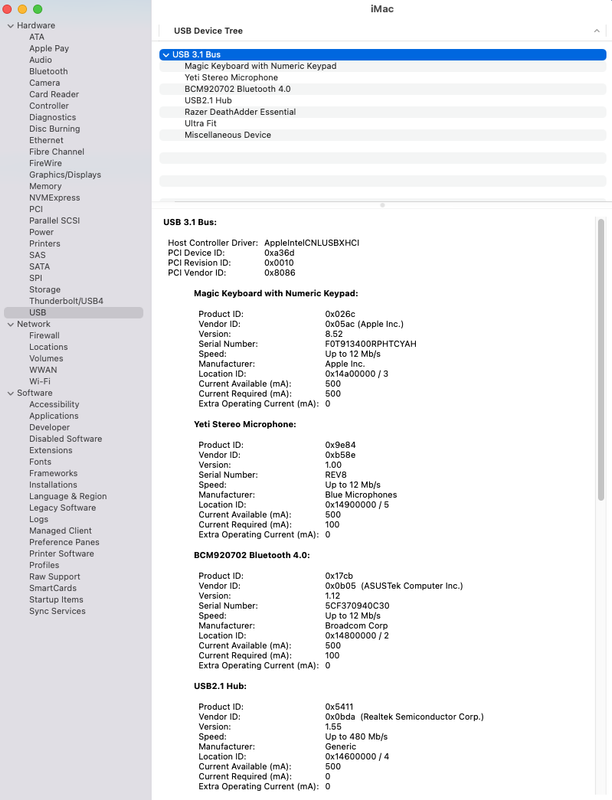

Trying to map ports on Z590 but all my USB3 devices are getting recognized as 480Mbps and work at USB2 speed only, what can be wrong here?spacer.png

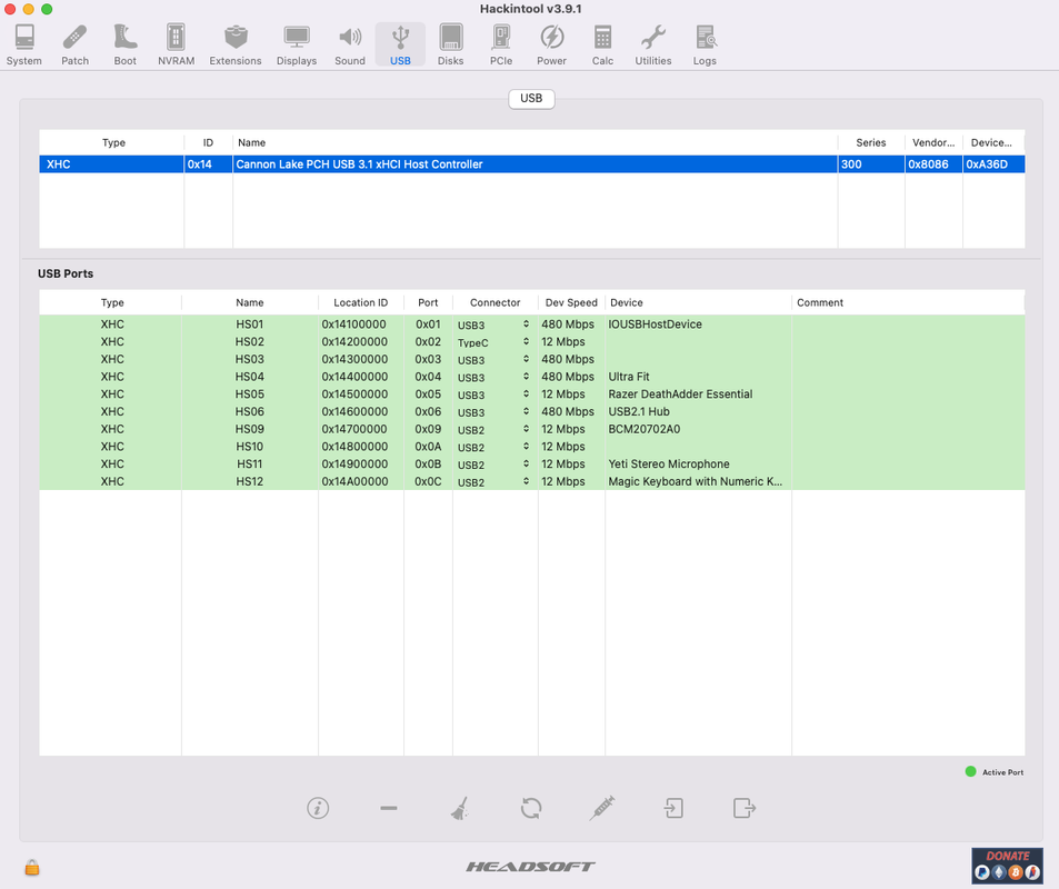

Using the DSDT.aml you created for me.and trying to map ports on Z390 m gaming but all my USB3 devices are getting recognized as 480Mbps and work at USB2 speed only.
Also try new USBinjectAll.kext 0.77 and XHCI -unsupported.kext , no lucky.
截圖 2021-11-25 上午10.25.59.zip DSDT.aml
u need remap HSxx ports first and SSxx ports start appears after that

On 11/25/2021 at 9:07 PM, MaLd0n said:
clean and refresh after reboot?
MaLd0n
Yap! Solved it. thanks!
Bcz I edited the wrong plist file on backup disk.

On my Gigabyte Z490I Aorus Ultra with macOS Monterey 12.3.1, all USB ports are only recognized as USB 2.0. A USB 3.0 and Type-C are not recognized and do not work. What could be the reason?

Hi MaLd0n,
While copying form usb3 drive the pen drive gets ejected frquently. The drive is still there but it shows message "the drive not ejected properly". All my usb3 ports shows this same message while copying from it. No problem with usb2 drives. usb3 shows 5Gbps in Hackintool and performs very fast.
Error Message : The operation cannot be completed because an unexpected error occurred(error code : 100006)
I followed your video using Hackintool
Olarila Monterey 12.3.1
i3 10105F, gigabyte h410m, geforce gt 710
I tried the same procedure in another system with gigabyte Z590, but still the same result.
please help

I tried mapping, restarting, cleaning , refreshing, USBInjectAll.kext, XHCI-unsupported.kext, SSDT-UIAC . But, I still don't see the SS ports in Hackintool and my usb 3 ports only go up to 480 Mbps. What else can I do or what am I doing wrong? Please help.
Mobo: GIGABYTE H370 AORUS Gaming 3 WIFI
Edited by risk_two
image reupload
start again and follow step by step
