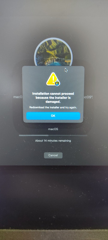

11 hours ago, MaLd0n said:
Why is this happening? I downloaded the installer 3 times
What did you use to create that bootable usb?
I used Balena Etcher to flash the premade image
you should create and new image..seems your image didn't finish downloading completely or it's corrupted.
How do I do that? I'm flashing the prefabricated image on another USB in case the problem is on the other USB
Re-download the image..and make sure you have the correct dsdt for you machine specifications..
Are the DSDT files from Clover compatible with OpenCore?

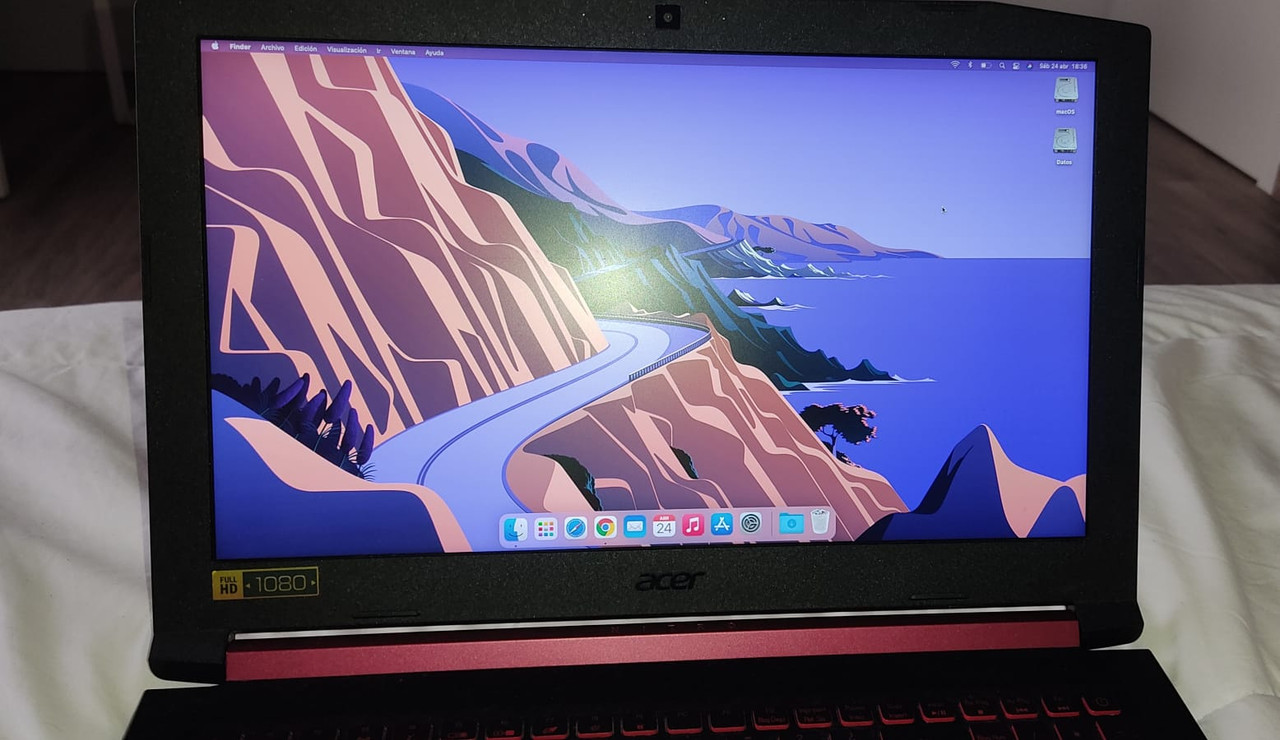

On 4/24/2021 at 7:42 PM, ru379 said:
Look! Thanks for your help. All works iGPU, Trackpad, Battery, WiFi, Ethernet and Bluetooth
You are welcome
