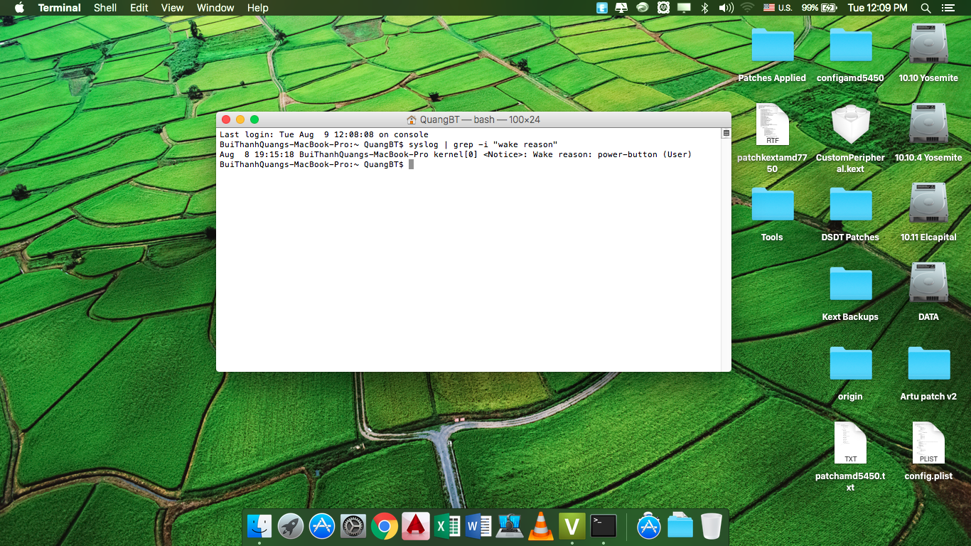

vinhkm6 Posted August 9, 2016 Posted August 9, 2016 hello check also sleep good hack hi I mean to sleep mode but it does not wake up, take off heat and then on to test consol sleep command in the terminal as well empty. I feel sad too
