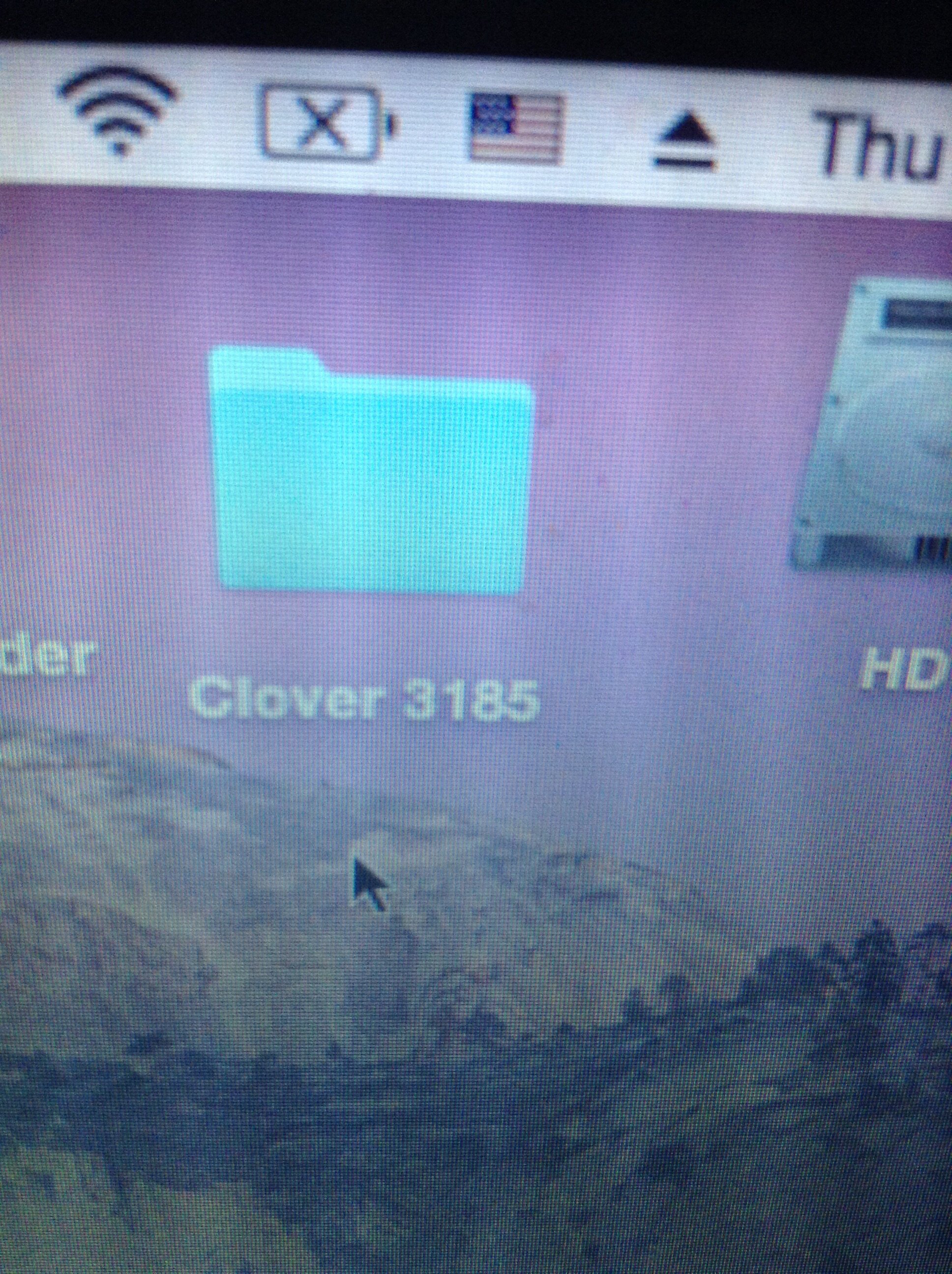

Also battery is not working properly.
before installing DSDT i've installed AppleSmartbatteryManager and it was working fine, the indicator on the menu bar was giving charge infos.
After putting on the DSDT battery it's working but there's always 100% carge, and it reads power supply on also when I'm unplugged, so i don't know how much charge I've left.

i give a little tweak in bat.. but that is a specific patch.. must do changes and test

And battery is still 100%, power supply connected, when currently I'm on battery.
