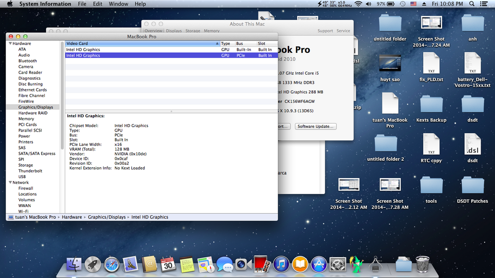

@supperchym
try to see in console any msg related with sleep and wake
i don't see nothing about loading any kext for the nvidia .. only intel hd .. maybe ur sleep problems are related
ur dsdt is already patched
good hack
@supperchym
good hack
Thanks. But i see nvdia in system information, some people say my device do not turn off nvidia optimus :( .
1845706087_ScreenShot2015-01-30at4_14_21AM.thumb.png.e7ad611f21cb086d409bca4fa7c5ddcf.png
hello
but if u see in terminal
kextstat
don't see any nvidia kext loaded
and u see that also in system info
nvidia
none kext loaded
so is doing nothing
