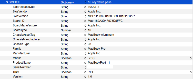

My SMBIOS is attached as image, I use clover so no smbios.plist

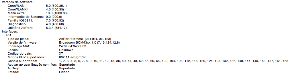

check also ur efi drivers .. read in clover .. maybe ur sleep problems come from there

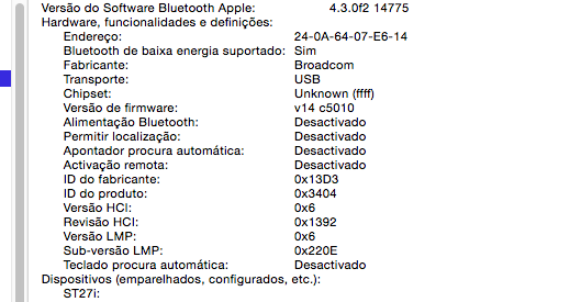

about the bluetooth i use same kext and no problems

The wake reason is XHC1 by AirPort_Brcm43xx::powerChange. That's why I'm suspecting the WiFi card or its Bluetooth part. Somethings makes it require the machine to wake up and that needs to be disabled. I don't know should that be done in kexts or where.
