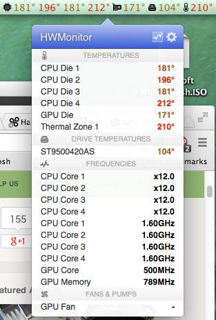

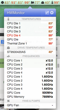

Hey guys, first of all I'd like to thank you all to take the time to help other people who has no idea what/how to do to get a patched DSDT file (like me).
These are my laptop specs: HP dv7 3085dx - Intel Core i7 720QM / 1.6 GHz (Mobile Intel HM55 Express) - (6.0GB (1x4GB 1x2GB) @ 1333.0 MHz / PC3-10600) - NVIDIA GeForce GT 230M - 1024.0 MB (1600 x 900 HD+).
The problem I'm having is overheating:
That's the laptop running Parallels with Windows 8 (installing Visual Studio 2012) on OSX 10.9.1.
Before posting here I've tried the following:
HWMonitor app shows the frequencies changing, I believe all cpus should run on "x12" which gives a total of 1.6 GHz, but sometimes when the laptop is performing intensive tasks that multiplier changes to "x13" (I haven't seen it changing to a larger multiplier) and at that frequency each core has 1.73GHz, hence -- IMHO -- the overheating.
Apparently the C-States implies idle status, while the P-States implies real work, I have black (good) temps from HWMonitor when the laptop is idle, so I guess the EnableCxState won't do much.
While I was playing with /Extra/org.chameleon.Boot.plist I've discover the HWMonitor app doesn't get any readings from "Thermal Zone 1".
Things I've changed in o.c.B.plist:
- GeneratePStates = Yes.
- GenerateCStates = Yes.
- EnableC3State = Yes.
- busratio = 12.
And I've tried several combinations of the previous boot flags. The laptop boots without any issue, but I'd like to lower the temp a bit, 90 © / 194 (F) seems to be too high.
Any help will be much appreciated, thanks in advance!!
