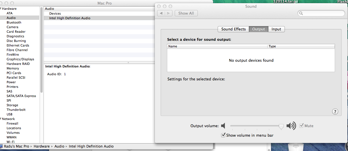

Radu66 Posted January 10, 2014 Posted January 10, 2014 I can get sound with voodoohda, but the volume is really low, and If i use "Gain" from settings I start to hear noise. I experimented with my dsdt and applehda to get them working, last thing that happened was KP, and the best thing that I can get is "Intel High Definition Audio: DeviceID:12(I suppose is the layout 12 from the dsdt) in System Informations. I don't have any working applehda.kext so I modified one with different data and I got nothing. I got everything I think to make it work:codec_dump.txt, codec_dump.txt.svg, codec_dump_dec (etc), device and vendor ids from Aida64, pin configs from voodoohda that I modified. I need some assistance with this, because I don't know now if AppleHDA is not working because of the kext or dsdt, I want some basic functions with AppleHDA. I am on Mavericks 10.9 Files.zip
artur-pt Posted January 11, 2014 Posted January 11, 2014 @Radu66 hello not easy mac os x and amd cpu... only apply hdef device with layout 1 to applehda http://Olarila.com/files/10.9/Audio/AppleHDA/ALC883/ALC883.zip try this one DSDT.aml.zip good hack PB Easy Note TM 86 - i5 430 M - H55M - Ram - 6 GB - Alc272 - Radeon HD 5470 512 QE/CI Lenovo G500 - i5 3230m - HM77 - Ram - 8 GB - Conexant audio - HD 4000 My OS X Files
Radu66 Posted January 11, 2014 Posted January 11, 2014 Now it looks like this, I can observe with "System Info" AppleHDA.kext not loaded. Any suggestions?
artur-pt Posted January 11, 2014 Posted January 11, 2014 hello no suggestions.. only hdef device is applied for injecting the correct layout id for applehda.. now u need one it works with ur hardware and it load by the system ( try to speak with mirone from the staff is the expert in applehda ) good hack PB Easy Note TM 86 - i5 430 M - H55M - Ram - 6 GB - Alc272 - Radeon HD 5470 512 QE/CI Lenovo G500 - i5 3230m - HM77 - Ram - 8 GB - Conexant audio - HD 4000 My OS X Files
