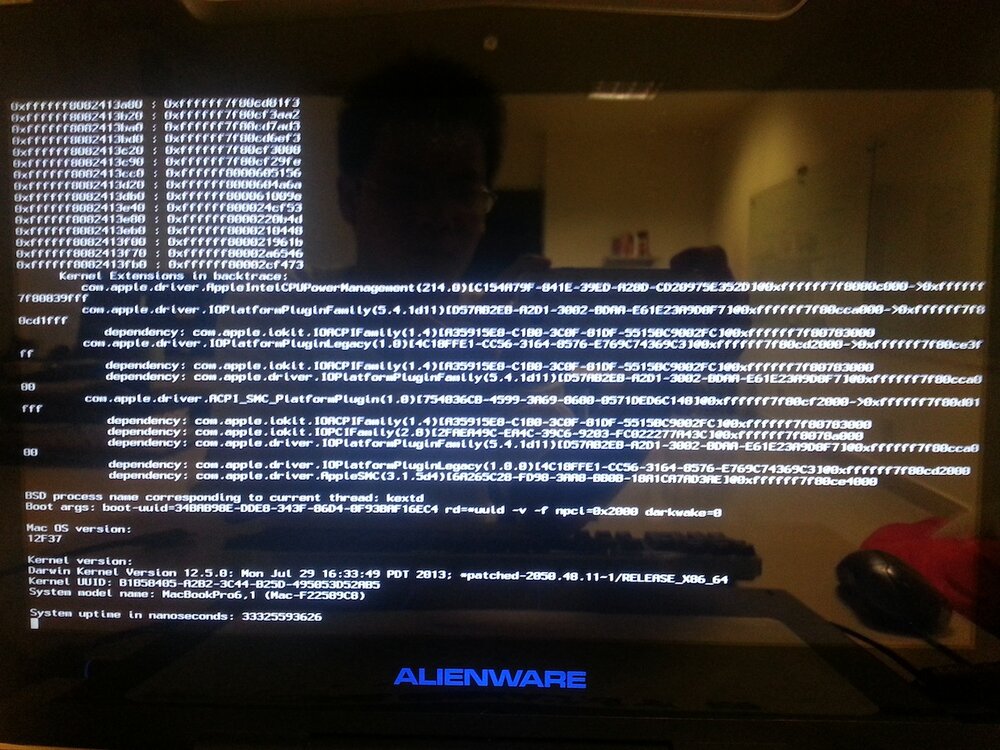

Hi artur i´m not using DSDT on lion, i´m using graphics enabler from chameleon and that is injecting the video.
So when i update to 10.7.5 or 10.8, the graphics enabler not found, i have a grey screen and i can´t see the desktop.
for that reason i need to patch my dsdt, to enable the video again on mountain lion.
Pd. the DSDT that i´ve attached is clean, it have the DTGP only, i resolve all errors and have 2 Warnings.
Pd3. I´m using iatkos M2.
Help me pls..

Hi Artur this´s the supposed code for my Nvidia G105M
The problem is, i don´t know where is it in DSDT, and when i put it under POP3 that´s where supposed go, when i compiled it give 201 error about i don´t what. Help please

Hi Artur sorry but not found, when the system load it´s black screen and i not have graphic
I see the Reg is incorrect in the DSDT, so i change it.
Can you see it please and many thanks for you big effort once again.

man is once again to guess where is ? u say before is in pop3...
copy to the right device all inside the wrong address and after delete the wrong GFX0
