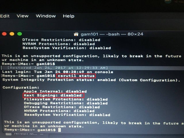

Hello MaLd0n! Thank you for trying to help me. :) I have been working on that Kext for a while now. And here is an update; :!:
I think I know why the Kext is not installing; there is a problem with the "Code Signing Failure: not code signed" (screenshot below) when I run the command;
"'kextutil /Library/Extenstions/RealtekRTL8111.kext".
I tried all the kexts for that LAN from the links you shared & other links, and got the same result. :wallbash
I have checked whether System Integrity Protection (SIP) is disabled in Clover & all the checkboxes under Options-System Parameters were checked & as you can see below, "Kext Signing" is disabled;
I don't know why kext loading if failing or how to make it work. Any ideas?

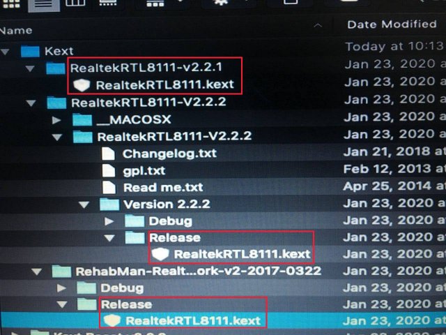

Here is a list of all Kexts I have tried;
Thank you again for all the help.
