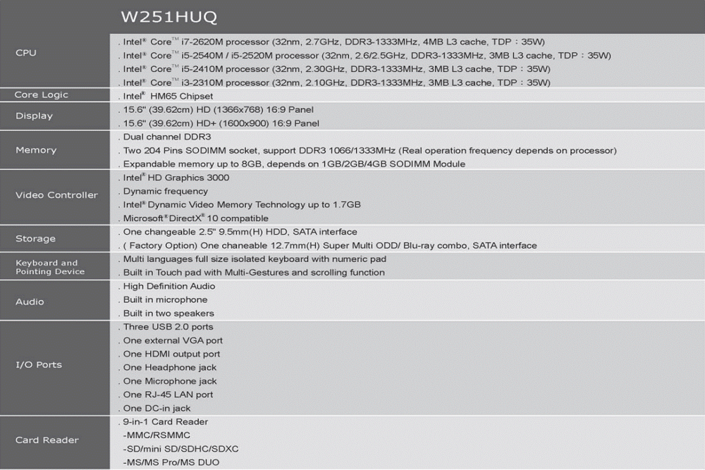

Hello,
I purchased a ZooStorm laptop and this particular company took over another company and re-branded the original, I contacted ZooStorm to find out the model name of the motherboard however they replied that they have the Motherboards pre-built but gave me the email address to the company who does design these motherboards. They replied to me with an image that had information based on my Motherboard which had the Model Name: W251HUQ along with the specifications that the board can take, I will attach this image to this forum. I am giving as much information as I possibly can due to the fact this company seems to be a bit un-heard of, following DSDT patch guides they always lead to going to forums such as this and downloading the patches. However because of my motherboard it's not present anywhere on any forums! So tonycrapx86 guide says if there isn't a patch in the database I should ask on here.
Laptop Specs;
Intel I3 2310m
Realtek RTL8191se wireless card
Realtek audio codec ALC269 (I think)
Intel HD3000 Graphics
Thank you very much for any help!
