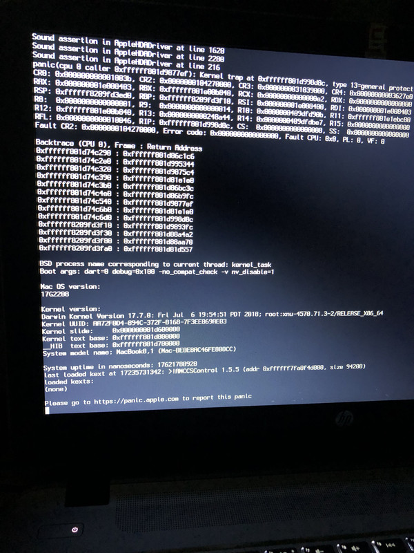

Hello,
Notebook HP Pavilion 14-v201tx
i5 5200
Intel HD Graphics 5500 + NVIDIA GF840M
HDD 750GB
RAM 12GB
I try to following guide install MacOS High Sierra 10.13.6,
1. I install use bootable USB > Config2 > Install > After Install
2. Select USB > Boot To macOS (I got Panic Report)
Can help me?
*After installation, boot from USB stick again, use boot key and select your SSD with system installed
Post by MaLd0n » 08 Jul 2019, 19:41
newbie555, viewtopic.php?f=62&t=9275
But i don't have any other mac, can i run hackintool and following steps on windows?
[ref]newbie555[/ref], no, disable video with intelgfx 0x12345678, boot into system and generate
newbie555, no, disable video with intelgfx 0x12345678, boot into system and generate
