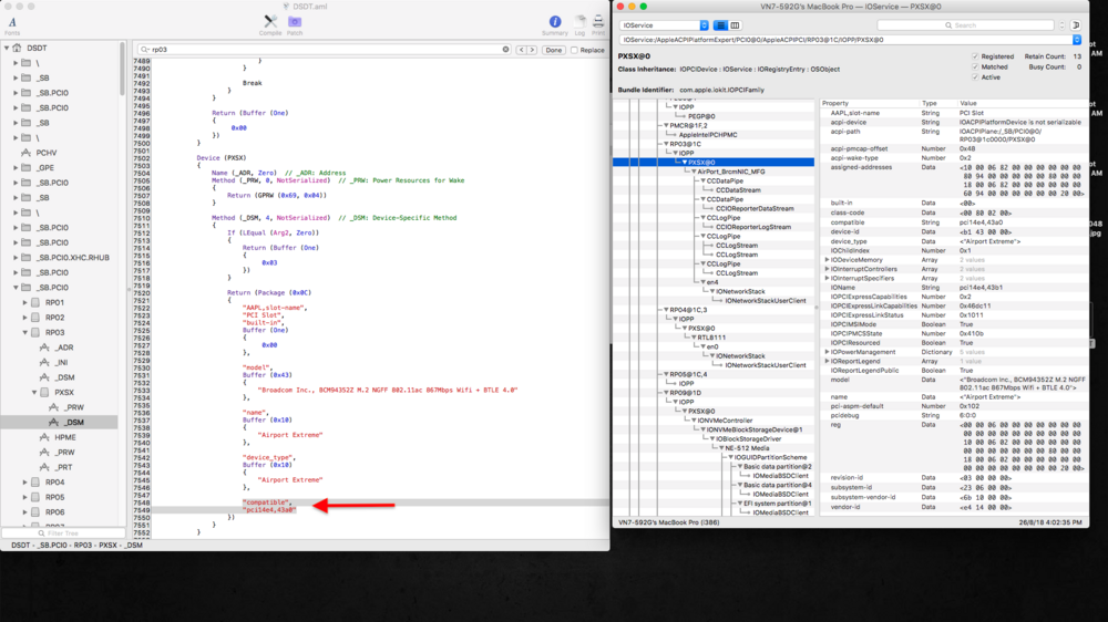

Enable Supported Wifi using DSDT method
There are a few ways to enable supported wifi card as documented in Toleda's guide. One of which is by using the ssdt method. I incorporated the ssdt into dsdt like in the picture attached. With this method, I do not require ssdt or kext to enable the wifi card.
Optionally, I renamed device PXSX at RP03 to Mac OS's device name ARPT via clover as shown in the picture.
92907410_ScreenShot2018-08-26at4_02_58PM.thumb.png.fabf9ee18c2e17941daf2bd6be565a34.png
782520091_ScreenShot2018-08-26at4_24_53PM.thumb.png.3ec2714e0f2cfaccd1e3cc44e088e426.png

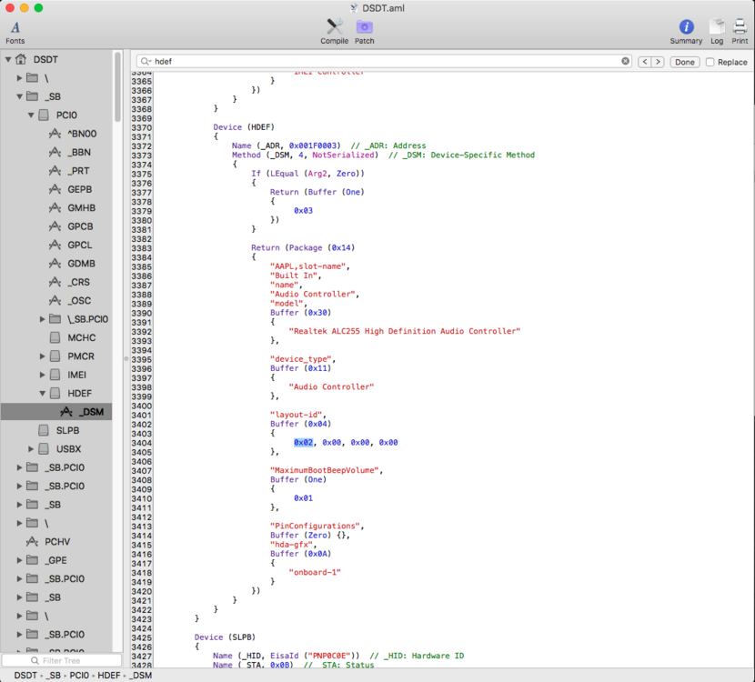

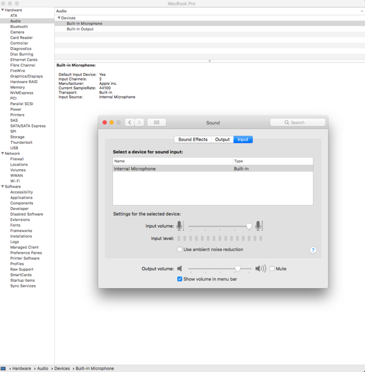

try this:
AppleHDA_ALC255_v1.zip
(1.73 MiB) Downloaded 1 time
Use Layout_id=2 in your DSDT or config.plist
Edit: Attach ss
No audio device is detected using the kext. FYI, I am using ID 27 with AppleALC if that helps.
PS: Port over thread here for sake of relevance :)
