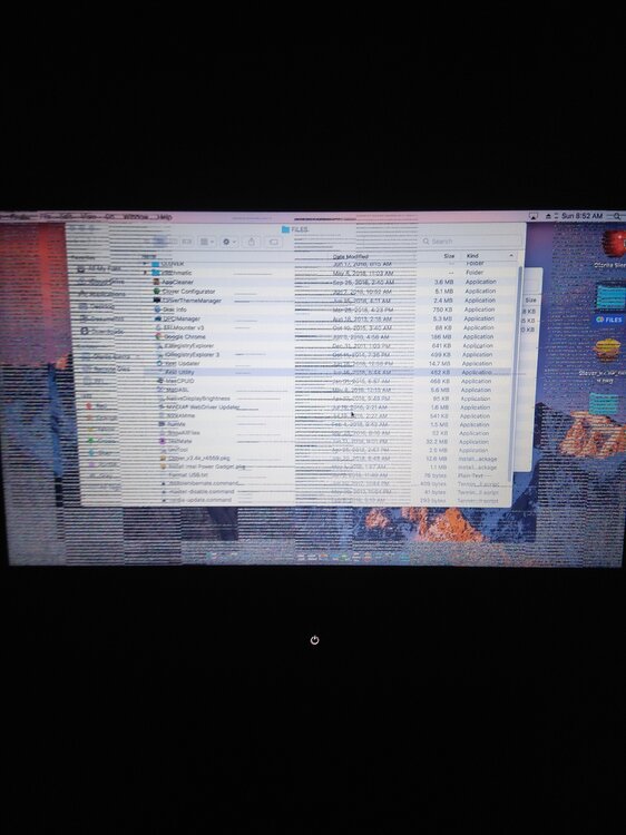

Issue #1 - graphic glatraching for Intel HD 4000. If i try to inject the values through clover but i can't able to save the updated files.

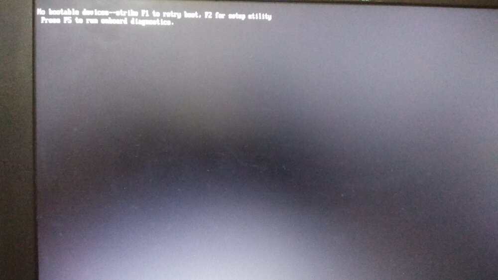

Isuse #2 - If bootable pendrive avlb on system then only i can able to boot the installed sierra from HDD else i get this kind of error.

Hai Allan, i have install kext from [ref]MaLd0n[/ref] patch suggestion. But no luck,it's still glitch like file attach.
Other things is, i can't boot from ssd directly, with usb removed. I've copied Clovet from usb too.

I've copied clover folder from you. Nothing change.
Still cannot boot from ssd and still glitch on there. It's look like clover not installed in ssd.

Now i can boot from ssd. The problem is in dell bios. I remove all booting item, and create one by pointing to ssd. Hope it's clear enough for ryasmca.
