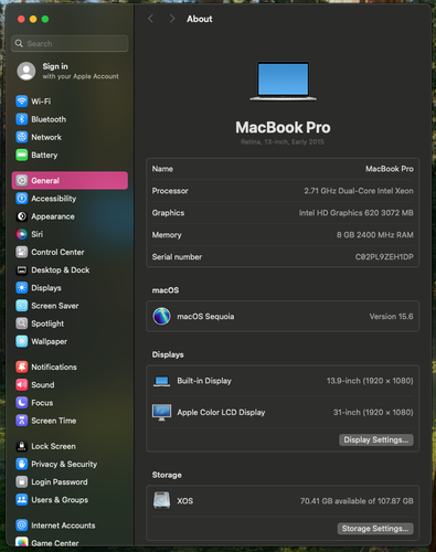

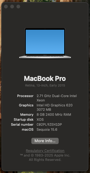

Fully working Lenovo 710-14IKB with Intel WIFI, perfect Realtek sound and JBL, tuned HD620.
All success instead of a touchscreen(device detected and looks possible to use but I have insufficient time to understand what with 7501 and GPIO I2C bus).

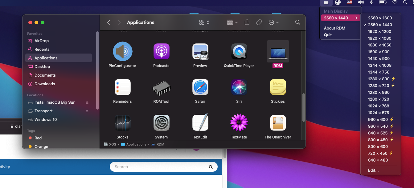

Found an application RDM making resolution of screen incredible for design, schematic and architect without modification of EDID, working after reboot and quality is super like a retina. Will try to make touchscreen working(something strange with a display vendor).

All works perfect instead of gyroscope sensor and touchscreen we don't know how to paired with intel and i2c gpio bus for now.

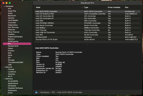

Small trouble I'd like to solve later is a hiding of all USB bus devices. Looks nothing plugged but works all ports after out of sleep and card reader looks into the void but works 🙂 ... strange shit(put SDCARD and look it's mounted successful).
Any enthusiasm to help me?
Wifi and Bluetooth works strange to but works. System indicators says no any WIFI hardware but using HeliPort all works.

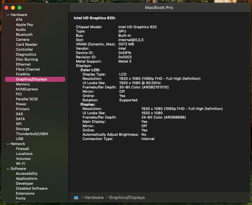

Graphics works better(apply a merging IntelHD connectors, pipes and buffers settings from 520+620+630+P630 and attach it to IrisPlus 655). Cool: works self by self after boot and system upgrade with acceleration and more dedicated memory.
To make that for fun CPU i5 delivered as unknown old XEON without integrated graphics.
