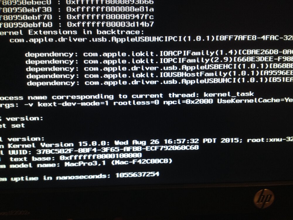

I choose Enoch as a bootloader , the installation has commplet normaly
but when i restart the pc then i boot from the usb and i choose the HDD to continue the install i have a kernel panic or something like that
a message like: system up 1000025552 nano seconde ?
any help please
thanks
can you provide a pic?
P.S i use Enoch as bootloader , in the first time when i boot from the usb i put boot Flags -v -f and it works fine , the install start good then when i arrived to the last steps i restart the PC to continue the install so i boot again from the usb then i choose the HDD to complete the install , i try to boot with or without Flags with No succes like in the pictures i have an error
I had this KP in my C2Q with ICH9 chipset, fixed it using my patched DSDT.
I guess the patch that fixes it is this one
http://Olarila.com/Patches/Desktop/ICH9%20USB%20sleep.txt

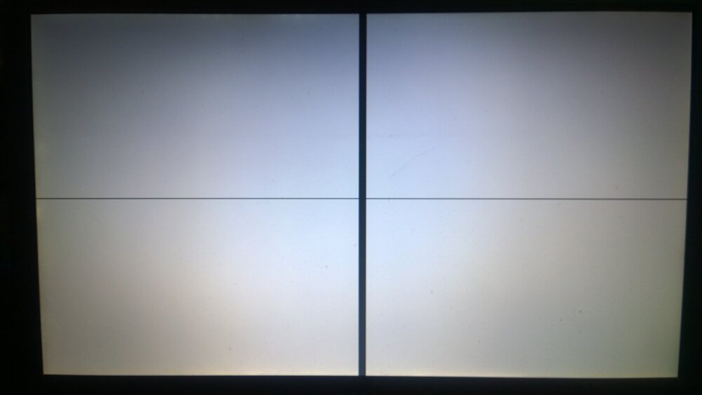

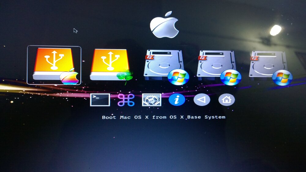

i'm new to hackintosh installation but at the boot screen boot mac osx from os x base system WP_20160601_20_23_37_Pro.thumb.jpg.1807e1b9d31006d90f926ecb4fb37f8f.jpg
after loading screen of apple logo white boxes appears and system rebootsWP_20160601_20_26_55_Pro.thumb.jpg.ce031858eb051db2617f49be3a0b971b.jpg
please help
