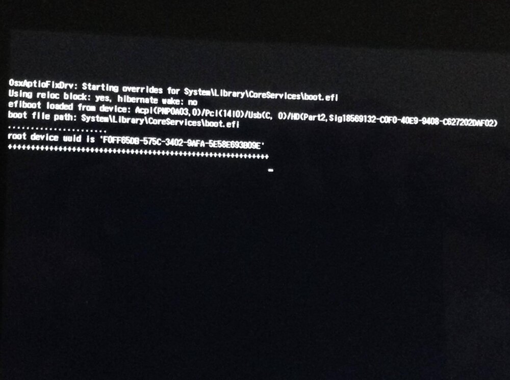

Hello,
I'm trying to install Yosemite from your bootable USB, but I get stuck at this screen:
Apparently is the "famous" Missing Bluetooth Controller Transport, but I've tried the method posted in "Common problems":
fsck -fy
mount -uw /
mkdir /kext_backup
cd /System/Library/Extensions
mv AppleIntelHD* AppleIntelSNB* AppleIntelFramebuffer* AMD* ATI* GeForce* NVDA* /kext_backup
kextcache -prelinked-kernel
reboot
And I'm still stuck at the same screen.
What should I do?
Sorry, I'm completely new to this and I don't know a thing... :S

I tried but no luck, still stuck at the same point.
I removed my gtx 960 and tried both normal and safe boot, but it didn't work.
It usuallly gets on hold like 20 secs on the previous line... I don't know if that could mean anything...

I finally managed to install Yosemite 10.10 and update to 10.10.4.
If anyone has the same hardware as me, the solution is to boot the installer with the flags dart=0 and nv_disable=1 (apart from the ones that come by default in clover).
When you finish to install it, you will notice it will seem quite slow... that's because the graphic card is disabled. Install all the drivers with multishit and upgrade to 10.10.4 via the App Store. Reboot and then download the Nvidia alternate graphic drivers from here:
http://www.nvidia.com/download/driverResults.aspx/88655/en-us
Reboot and select the Nvidia graphics instead of the Mac OS native (you can do it by pressing the new icon in the upper bar). Reboot and you'll notice everything goes smoother.
I had problems with the audio, in my case Realtek ALC892. The issue can be solved by installing generic drivers and not the Realtek ones. Just follow these instructions:
http://www.hackintoshosx.com/topic/22329-alc892-alc887-voodookext-optimized-for-yosemite/
Hope that helps someone! :)
