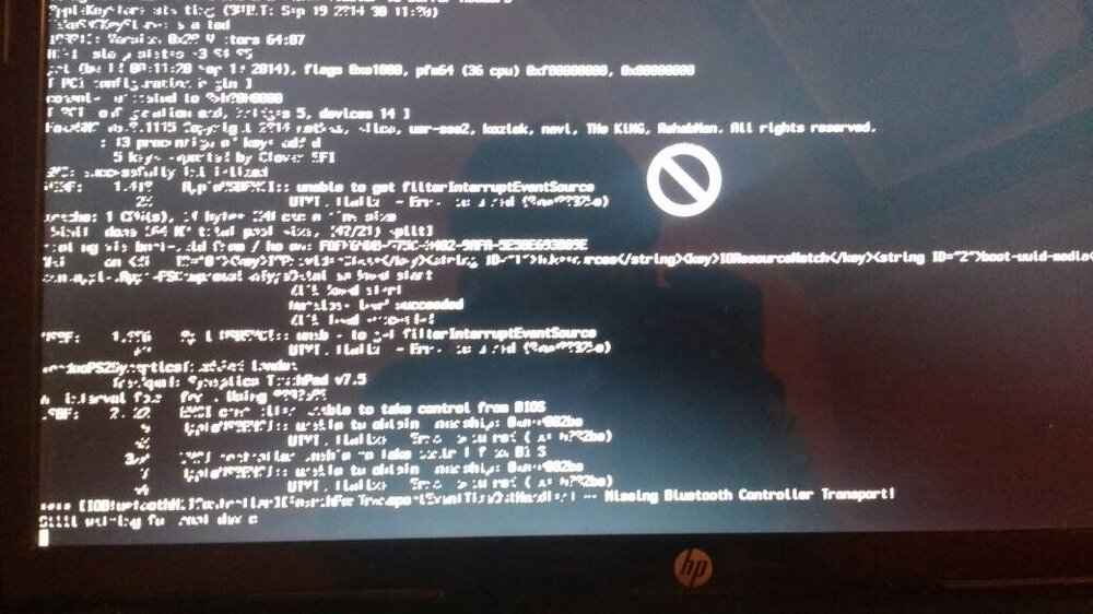

newdoodle Posted May 24, 2017 Posted May 24, 2017 Hi, I tried installing it on my laptop. I preferred chameleon over clover at first. BUT chameleon didn't work at all. It stopped after the following - no ramdisk config mounting done I tried with clover, and added cpus=1 and it took me till Missing bluetooth controller transport. Then the screen distorted. I am attaching screenshots. Please help

newdoodle Posted May 25, 2017 Posted May 25, 2017 Enable USB Ownership in Clover options (PCI devices menu) I tried with the following - USB Ownership cpus=1 7 series patch HP laptop kernel patch Still got the same issue but it was a little different this time.
pernacabeluda Posted May 25, 2017 Author Posted May 25, 2017 Did you try the other USB fixes together with USB Ownership? https://clover-wiki.zetam.org/Configuration/Devices#devices_usb -Guides and Tutorials HERE -Hackintosh Tutorial Database - HERE -The largest EFI folder collection for Hackintosh HERE -Support Olarila Vanilla Hackintosh by making a donation HERE -Professional Consulting for macOS Hackintosh since 2006 HERE
newdoodle Posted May 25, 2017 Posted May 25, 2017 Nope I didn't try any other fixes than the ones I told How to write these in clover? Also I am not able to boot into single user mode to edit for the Bluetooth issue. As soon as I press enter on single user verbose mode, clover starts to boot like usual followed by the same error.
pernacabeluda Posted May 25, 2017 Author Posted May 25, 2017 You can enable the fixes in options menu, under devices. Your problem is USB (waiting for boot device), not bluetooth. -Guides and Tutorials HERE -Hackintosh Tutorial Database - HERE -The largest EFI folder collection for Hackintosh HERE -Support Olarila Vanilla Hackintosh by making a donation HERE -Professional Consulting for macOS Hackintosh since 2006 HERE
newdoodle Posted May 25, 2017 Posted May 25, 2017 You can enable the fixes in options menu, under devices. Your problem is USB (waiting for boot device), not bluetooth. Okay thanks I will try the fixes from the link you provided.
newdoodle Posted May 25, 2017 Posted May 25, 2017 Did you try the other USB fixes together with USB Ownership? https://clover-wiki.zetam.org/Configuration/Devices#devices_usb Thanks it worked, I was able to boot into the installer.
