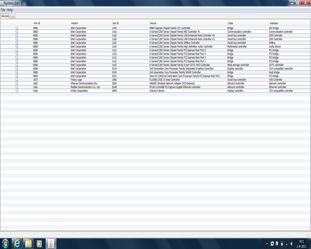

So please mald0n en others user help me on this i would really appreciate it. i also would like if u can fix my buggy DSDT. i'm also including my EDID from windows.
Here you have my files + Systems info:
EDID.zip
Extra.zip
Atheros 9285

The Atheros patch is an example, you have to look in IORegistryExplorer the correct address
In my case the WLAN is inside RP02@1C,1 (0x001C0001).

Sorry, the Atheros patch was wrong, first remove it with
into method label _DSM parent_adr 0x001C0001 remove_entry
then download and apply it again
http://Olarila.com/Patches/Atheros%209285.txt
Change the values according to your ioreg (WLAN@0 and RP02@1C,1)
into device name_adr [color=#FF0000]0x00[/color] parent_adr [color=#FF0000]0x001C0001[/color] insert
