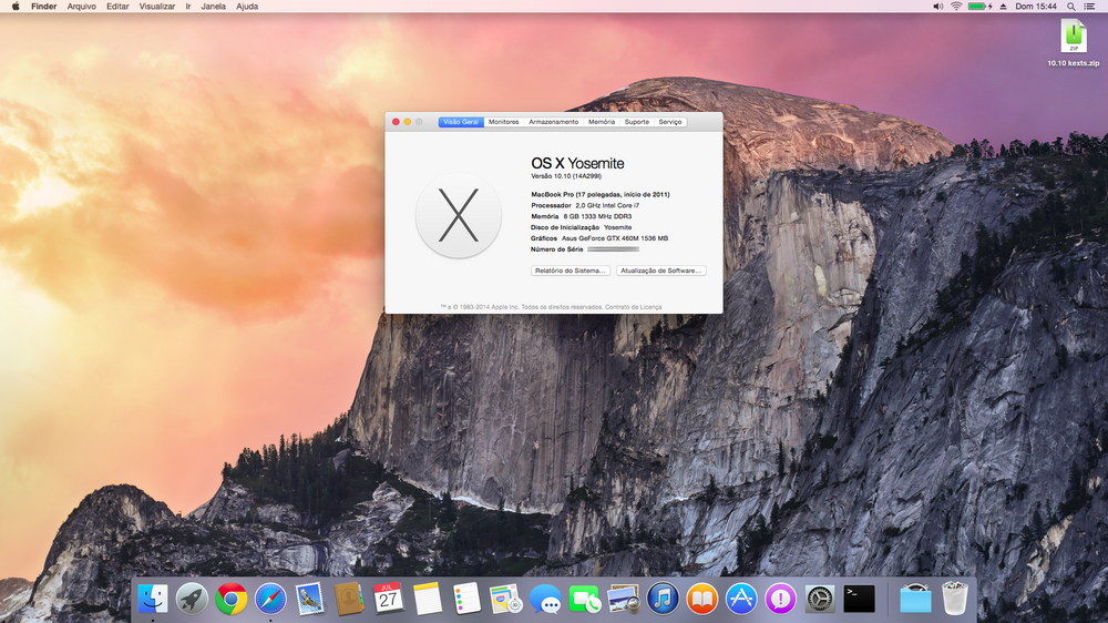

You seem to have had better luck with me on this laptop. Have you had any luck with the Yosemite Public Beta?
Yes, it's working very well.
Build the installer using this method
http://Olarila.com/forum/viewtopic.php?f=36&t=4632
Add the Board-ID into ConfigMap in the file /System/Library/Extensions/AppleGraphicsControl.kext/Contents/PlugIns/AppleGraphicsDevicePolicy.kext/Contents/Info.plist
                                <key>Mac-942459F5819B171B</key>
                               <string>none</string>
Boot the installer in single user mode and run
fsck -fy
mount -uw /
rm /System/Library/Caches/com.apple.kext.caches/Startup/kernelcache
kextcache -prelinked-kernel
exit
If kextcache ends in segmentation fault, run it again until kernelcache is built.
Use the same kexts as 10.9.4, except AppleHDA and GenericUSBXHCI
10.10 kexts.zip
793653685_CapturadeTela2014-07-27s15_44_49.thumb.png.29076624cc83605a22cc21826125e676.png
