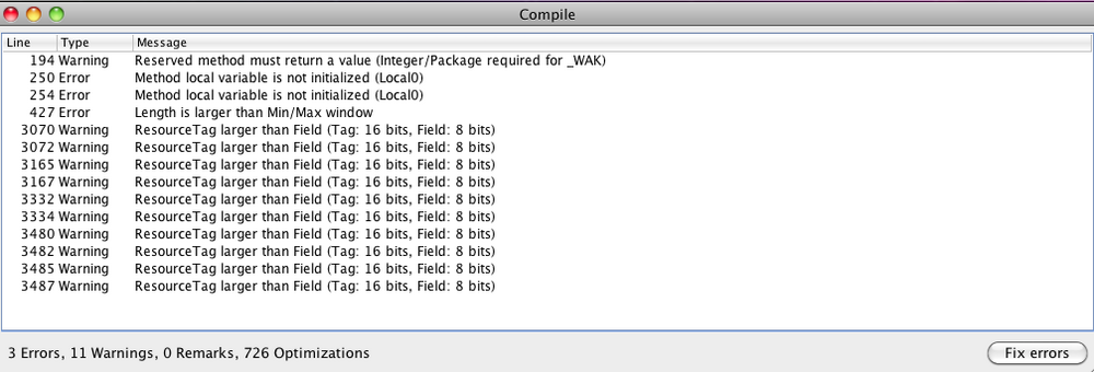

I try to make a DSDT for my Hackintosh so I decide to take the DSDT Editor from here and the Patch
This is how I do it:
1.Boot into my System wich is OS X 10.6.8 launch DSDT Editor and Extract the DSDT
2.Just to check I the file is ok I try to compile the DSDT and get 3 Errors, 11 Warning, 0 Remarks, 276 Optimization
3. I click on the Button fix Errors and they get away
4.Patched the DSDT to get rid of the 194 (WAK) warning
So after all this is done I am still left with 10 Warnings
how can I get rid of them
here are the codes if its helps more

I would not modify that but if you really want to eliminate the warnings change CreateByteField to CreateWordField.

I didn't say you shouldn't patch the warning lines, I said I would not, just because it works fine how it is.
