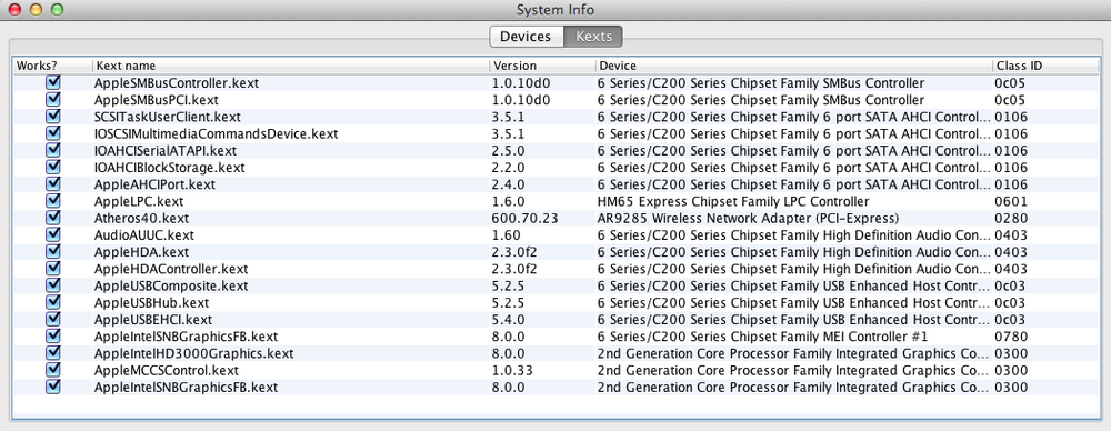

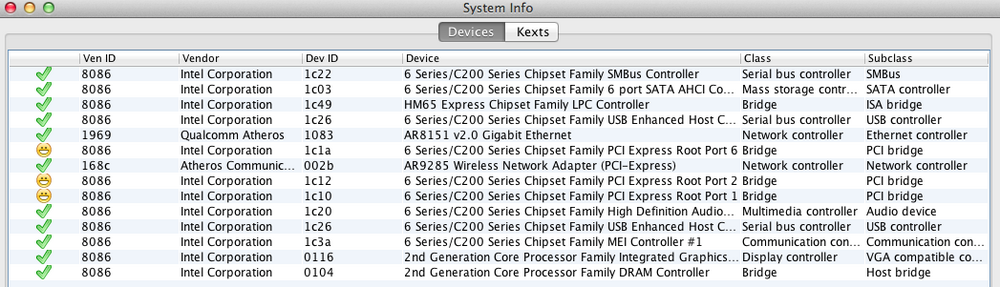

Hi there.
Patched IOAudiofamily fixed no sound after sleep and Patched AppleACIPlatform fixed battery info. The only thing about that is Fn keys don't work, the rest yes, I dont know why.
Do I need IOPCIFamily, lspcidrv and Patched_10.7_AppleRTC in my E/E folder?
and may you give me a hint about SDcard and Bluetooth
Thanks

Hi Artur I cant find any solution about the USB ports missing also I'd like to ask you how to enable HDMI audio if you dont mind...
Thanks.

Hello.
Really hard dude, I've got it , though.
If u could give me a hand about the USB ports I'd really appreciated. It's the only thing left for a 100%vanilla hack.
