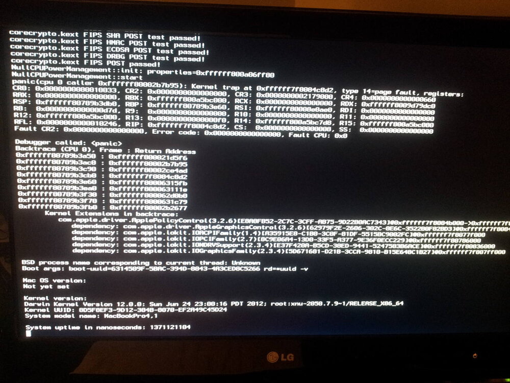

Hello Everyone,
Been trying to get ML on my system for hours.
Booted from usb drive and installed ML successfuly but problems starts when try to boot for the first time.
Tried loads of commands but nothing works.
Been stuck on this error.
waitforservice [appleintelcpupowermanagement] timed out
I have attached screenshot and my system specs are down below.
Hope someone will help me out.
Thanks!! :)
Probably a video problem http://Olarila.com/forum/viewtopic.php?f=27&t=1677
