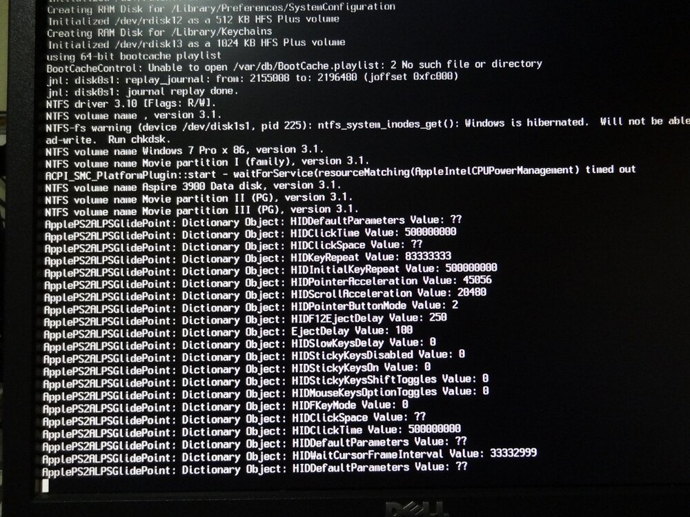

I tried to install ML from USB. My desktop i s Acer Aspire x3900Processor
Intel Core i3-530
MB Acer FIH57
chipset Intel H57 Express
Graphic Intel GMA X4500
Audio HD audio
LAN 82578 Gigabit Ethernet
OSX Lion 10.7.4 was installed well ( Niresh's DVD)
I boot the system form USB using -v and stuck as in attached screen.
https://skydrive.live.com/redir?resid=133ECE7D01FFA3F!386/img]
I used PS2 mouse and Keyboard initially.
I replaced them with USB mouse and Keyboard now but problem remain.
Please advise me what went wrong and how can I solve it.
Thanks
hello
gma4500 is not supported
remove from the installer all appleintelhd*.kext
and try to boot
-f
