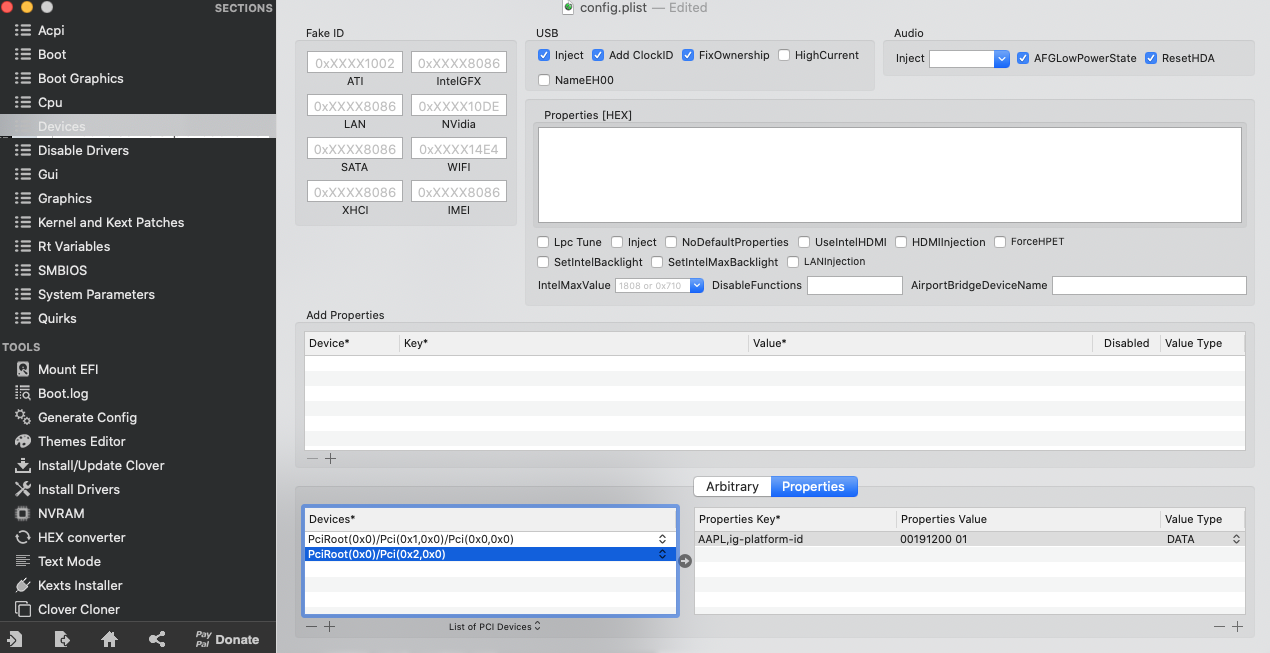

I found some explanations how to disable unsupported dGPU:
Under Devices -> Properties -> Devices, we can add our PCI route with the following properties:
Nvidia users:
Properties Key* Properties Value        Value Type
name            23646973706C6179        data
IOName          #display                string
class-code      FFFFFFFF                data
and added it to config.plist under Devices/Properties (PciRoot(0x0)/Pci(0x1,0x0)/Pci(0x0,0x0))
Got kernel panic, but booted up use flag Inject Intel; first card not in the system,  added second card to the system, got kernel panics, added flags Inject Nvidia, Load Vbios, removed Inject Intel, booted up.
Added

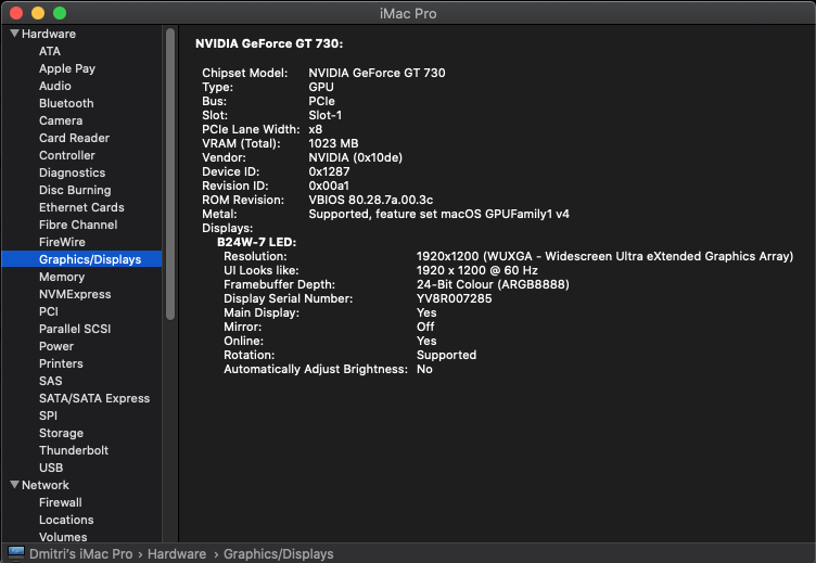

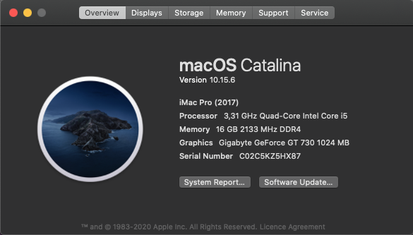

That GT730 have 2GB of memory, but MacOS shows only 1GB,
That to do to display card right and I have big issue , screen blinks black all the time.

Added SendME is new, both card inside, GTX1650 PciRoot(0x0)/Pci(0x1,0x0)/Pci(0x0,0x0) disabled.
GT730 PciRoot(0x0)/Pci(0x1,0x1)/Pci(0x0,0x0) gigabyte gv-n730d5-2gi
u dont need any properties in Devices
Even not for disabling one card? Are you a magician? :)

But how to setup BIOS on the motherboard? First video iGFX or GT730?
in this case i think the best solution is igpu stay enable for Intel Quick Sync
gt730 stay in second slot, correct?
save one ioreg with my last dsdt
change smbios to iMac17,1 and check if hardware accel work
It was same, not working. That GT730 is not better than HD530, its only a sleep, maybe it will be better if i buy a some low budget AMD, some Sapphire Radeon HD and got sleep working? Don't waste time for GT730, its not worth it.
