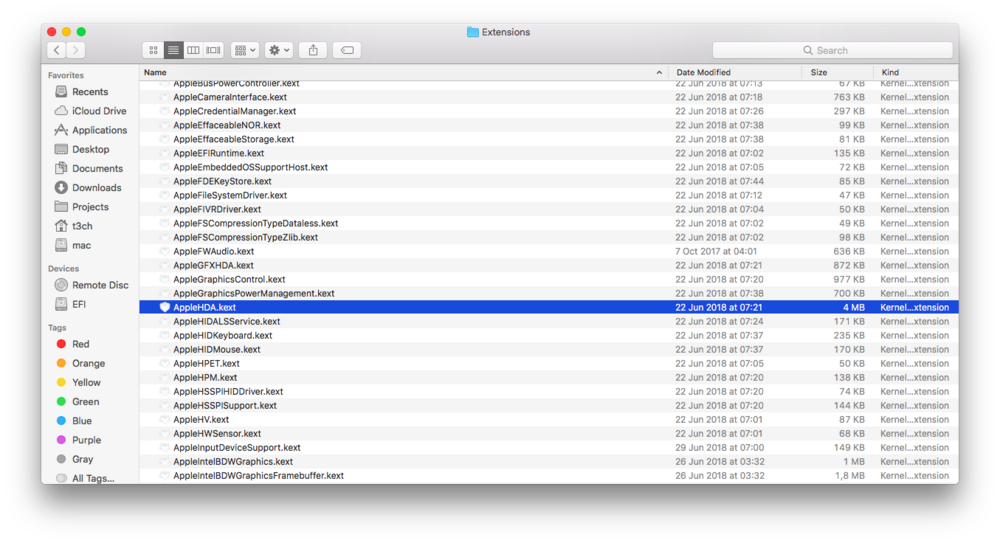

Boot para antes de entrar no ambiente gráfico
DSMOS has arrived
Missing Bluetooth Controller Transport
Mover as kexts de vídeo pelo single user (pressione a barra de espaço e boot in single user verbose mode)
Code: Select all
fsck -fy
mount -uw /
mkdir /kext_backup
cd /System/Library/Extensions
mv AppleIntelHD* AppleIntelSNB* AppleIntelFramebuffer* AMD* ATI* GeForce* NVDA* /kext_backup
kextcache -prelinked-kernel
reboot
